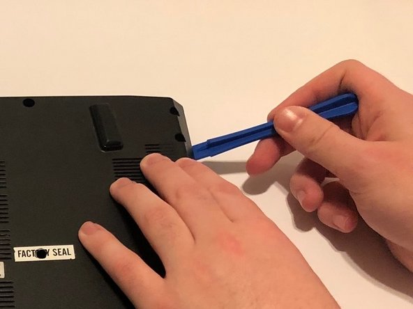

  3. MSI GE62 7RD RAM Replacement: passo 3, immagine 1 di 2 MSI GE62 7RD RAM Replacement: passo 3, immagine 2 di 2
    • Remove the back case from the laptop.
    • If the backing is really stuck, you may use a plastic opening tool or picks to provide leverage.
