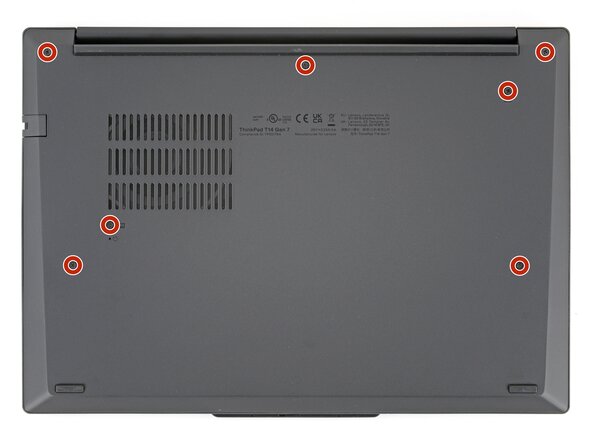

  2. Lenovo ThinkPad T14 Gen 7 Battery Replacement, Loosen the base cover screws: passo 2, immagine 1 di 2 Lenovo ThinkPad T14 Gen 7 Battery Replacement, Loosen the base cover screws: passo 2, immagine 2 di 2
    • Use a Phillips screwdriver to fully loosen the seven captive screws securing the base cover.

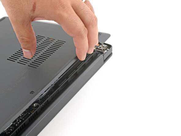

  3. Lenovo ThinkPad T14 Gen 7 Battery Replacement, Remove the base cover: passo 3, immagine 1 di 3 Lenovo ThinkPad T14 Gen 7 Battery Replacement, Remove the base cover: passo 3, immagine 2 di 3 Lenovo ThinkPad T14 Gen 7 Battery Replacement, Remove the base cover: passo 3, immagine 3 di 3
    • The base cover is still lightly clipped to the laptop.
    • Use your fingers to grab and lift the top-right corner of the base cover near the hinge.
    • Repeat at the top-left corner.
  4. Lenovo ThinkPad T14 Gen 7 Battery Replacement: passo 4, immagine 1 di 3 Lenovo ThinkPad T14 Gen 7 Battery Replacement: passo 4, immagine 2 di 3 Lenovo ThinkPad T14 Gen 7 Battery Replacement: passo 4, immagine 3 di 3
    • Slowly lift the hinge edge of the base cover until the remaining clips release.
    • Remove the base cover.
    • During reassembly, align the base cover's bottom edge tabs with the laptop, then lay the cover in place. Press around the perimeter to clip the base cover to the laptop.
