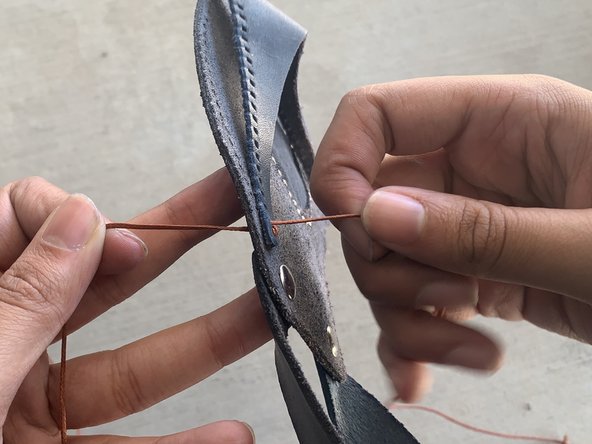

  5. Leather Stitching Replacement: passo 5, immagine 1 di 3 Leather Stitching Replacement: passo 5, immagine 2 di 3 Leather Stitching Replacement: passo 5, immagine 3 di 3
    • Line up the first hole on both pieces.
    • Push one needle all the way through.
    • Pull till the length of the thread is equal on each side.
  6. Leather Stitching Replacement: passo 6, immagine 1 di 3 Leather Stitching Replacement: passo 6, immagine 2 di 3 Leather Stitching Replacement: passo 6, immagine 3 di 3
    • You should have a needle on the right side of the leather and one on the left.
    • Push the right side needle through the second hole.
    • Push the left side need through the same hole.
    • Tug each side to tighten the stitch.
    • After tugging, you will end up having a needle on the right side and left side.
  7. Leather Stitching Replacement: passo 7, immagine 1 di 1
    • With each hole, make sure both needles go through to the other side and are pulled together to tighten the stitch.
    • Continue this pattern until the end.

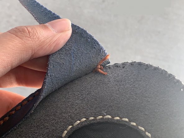

  8. Leather Stitching Replacement: passo 8, immagine 1 di 3 Leather Stitching Replacement: passo 8, immagine 2 di 3 Leather Stitching Replacement: passo 8, immagine 3 di 3
    • To finish the stitch, we are going to push the needle into the second-to-last hole.
    • It should not pass through both pieces, only the one piece.
    • Do this for both sides.
  9. Leather Stitching Replacement: passo 9, immagine 1 di 3 Leather Stitching Replacement: passo 9, immagine 2 di 3 Leather Stitching Replacement: passo 9, immagine 3 di 3
    • Tie the finishing knot by crossing the threads and pushing the needle through the made hole.
    • Pull to tighten and repeat once.
