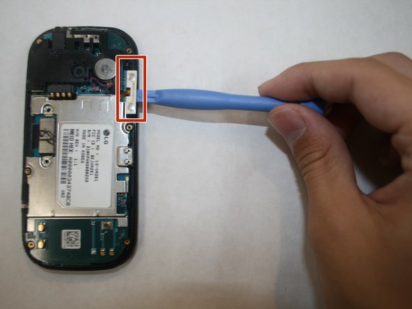

    • Use a spudger to carefully detach the volume buttons.
    • The volume buttons are attached to a cable on the motherboard. Do not try and take them off completely.

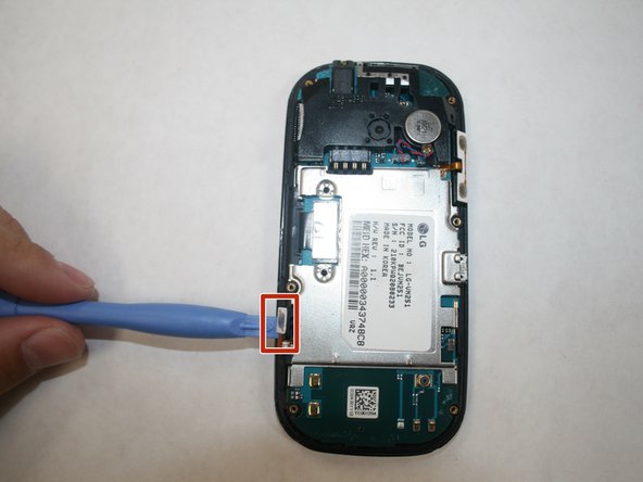

    • Use a spudger to carefully detach the camera button.
    • The camera button is attached to a cable on the motherboard. Do not try and take it off completely.
