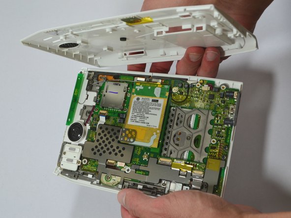

  3. Kindle 1st Generation ON/OFF Power and Wifi Switches Replacement, ON/OFF Power and Wifi Switches: passo 3, immagine 1 di 1
    • Unscrew eight (8) Phillips #00 screws (3 mm).
  4. Kindle 1st Generation ON/OFF Power and Wifi Switches Replacement: passo 4, immagine 1 di 2 Kindle 1st Generation ON/OFF Power and Wifi Switches Replacement: passo 4, immagine 2 di 2
    • Start at one side of the device. Use a soft plastic prying tool to separate the casing of the device. Slowly work your way around the entire device.
    • Avoid prying between the buttons and the device. This could cause damage to the buttons.
