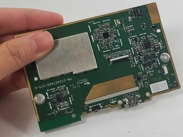

  7. Kindle 10 LED Status Light Replacement: passo 7, immagine 1 di 2 Kindle 10 LED Status Light Replacement: passo 7, immagine 2 di 2
    • Pry the motherboard away from the display frame

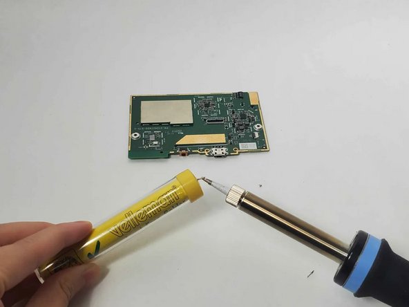

  8. Kindle 10 LED Status Light Replacement, LED Status Light: passo 8, immagine 1 di 3 Kindle 10 LED Status Light Replacement, LED Status Light: passo 8, immagine 2 di 3 Kindle 10 LED Status Light Replacement, LED Status Light: passo 8, immagine 3 di 3
    • Follow the guide How To Solder to prepare your soldering iron.

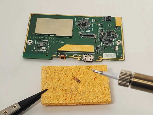

    • Turn on the soldering iron.
    • Clean the tip after the old solder has melted by dragging it across a sponge.
    • Prime the soldering iron by touching its tip with a dab of lead-free wire. Your soldering iron is ready when the solder readily melts.

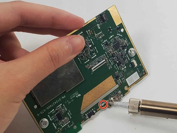

  9. Kindle 10 LED Status Light Replacement: passo 9, immagine 1 di 3 Kindle 10 LED Status Light Replacement: passo 9, immagine 2 di 3 Kindle 10 LED Status Light Replacement: passo 9, immagine 3 di 3
    • Touch the soldering iron's tip to the two joints on the front and back of the LED for 5 seconds, or longer if it is not melted.
    • Use tweezers to pull out the LED once it is loosened.
    • Always use tweezers to handle components near the soldering tip as it will be hot.

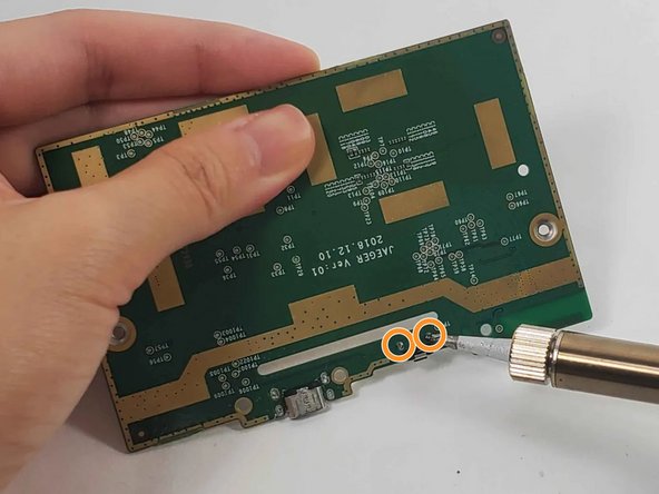

  10. Kindle 10 LED Status Light Replacement: passo 10, immagine 1 di 3 Kindle 10 LED Status Light Replacement: passo 10, immagine 2 di 3 Kindle 10 LED Status Light Replacement: passo 10, immagine 3 di 3
    • Search for "Through-Hole Soldering" on this How To Solder guide to ensure you replace and solder the LED correctly.
    • Align your new replacement LED in the correct location.
    • Pull the wires on each side of the new LED through the holes in the circuit where the LED was previously.
    • Solder its joints in the back. Be sure the soldering joints create a concave tent shape indicating a strong connection.
    • Use a tool such as tweezers to hold the new LED in place so that your hands are not near the hot soldering iron.
