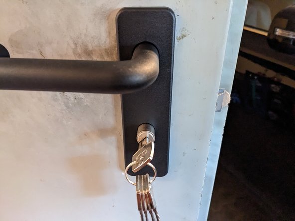

  1. How to replace a Euro Cylinder in a Mortise Lock, Measure the cylinder: passo 1, immagine 1 di 1
    • Open the door.
    • Measure the distance from the the forend screw holding the cylinder to the faceplate as shown in the picture.
    • Buy the new cylinder.
    • The maximum overhead you can dimension the new cylinder too large is 2mm. If The cylinder sticks out too much it becomes vulnerable to cracking.
  2. How to replace a Euro Cylinder in a Mortise Lock, Remove the screw: passo 2, immagine 1 di 1
    • Use a PZ2 screwdriver to remove the fixing screw from the side of the lock.
    • Some older locks might use a slotted screw instead.
  3. How to replace a Euro Cylinder in a Mortise Lock, Remove the cylinder: passo 3, immagine 1 di 3 How to replace a Euro Cylinder in a Mortise Lock, Remove the cylinder: passo 3, immagine 2 di 3 How to replace a Euro Cylinder in a Mortise Lock, Remove the cylinder: passo 3, immagine 3 di 3
    • Insert the key and turn it to about 20° to the right (or left) to release the cylinder from the lock insert.
    • If you don’t have the old key or the cylinder doesn’t work anymore you can give this guide a try.
    • Pull out the old cylinder.
