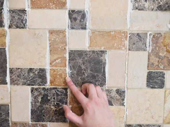

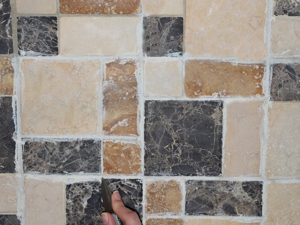

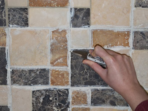

  1. How to fix Leaks in Shower Tiles by Caulking, How to fix Leaks in Shower Tiles by Caulking: passo 1, immagine 1 di 3 How to fix Leaks in Shower Tiles by Caulking, How to fix Leaks in Shower Tiles by Caulking: passo 1, immagine 2 di 3 How to fix Leaks in Shower Tiles by Caulking, How to fix Leaks in Shower Tiles by Caulking: passo 1, immagine 3 di 3
    • Using a putty knife, remove the old caulk from the surface.
    • While using the scraper, hold the sharp end away from you.

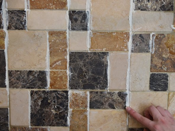

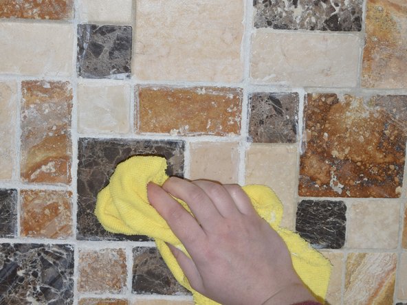

  2. How to fix Leaks in Shower Tiles by Caulking: passo 2, immagine 1 di 3 How to fix Leaks in Shower Tiles by Caulking: passo 2, immagine 2 di 3 How to fix Leaks in Shower Tiles by Caulking: passo 2, immagine 3 di 3
    • Using a damp cloth, wipe the surface to remove the scraped caulking.
    • Using another cloth, wipe the surface with disinfectant.

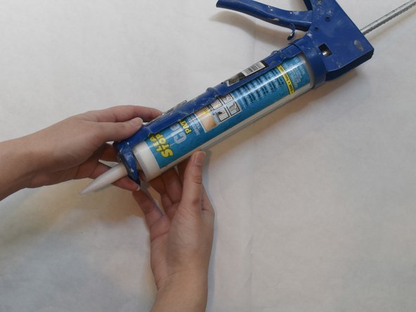

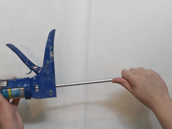

  3. How to fix Leaks in Shower Tiles by Caulking: passo 3, immagine 1 di 3 How to fix Leaks in Shower Tiles by Caulking: passo 3, immagine 2 di 3 How to fix Leaks in Shower Tiles by Caulking: passo 3, immagine 3 di 3
    • Place the caulking tube in the caulking gun.
    • Place the back of the tube into the gun.
    • Push the front of the tube inside.
    • Twist the hook at the end of the caulking gun inwards to hold the caulking tube in place.

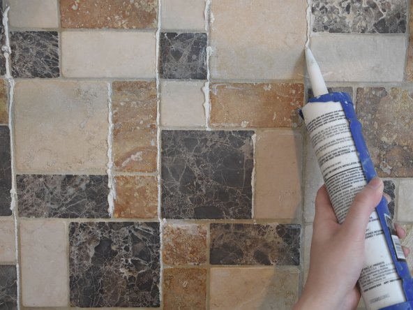

  5. How to fix Leaks in Shower Tiles by Caulking: passo 5, immagine 1 di 3 How to fix Leaks in Shower Tiles by Caulking: passo 5, immagine 2 di 3 How to fix Leaks in Shower Tiles by Caulking: passo 5, immagine 3 di 3
    • Start caulking at the top of the surface and move down along the surface.
    • Place the tip of the caulking gun on the surface between two tiles and move it down at a steady pace.
    • Go back to the top and apply the caulking on the next tile, until all of the space between the tiles has caulking.
    • Hold the caulking gun with both hands to be steady.

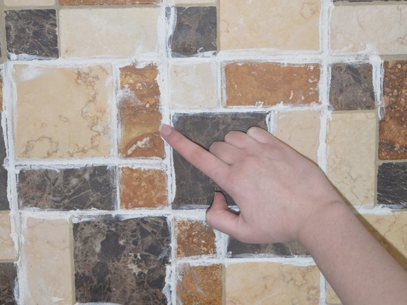

  6. How to fix Leaks in Shower Tiles by Caulking: passo 6, immagine 1 di 3 How to fix Leaks in Shower Tiles by Caulking: passo 6, immagine 2 di 3 How to fix Leaks in Shower Tiles by Caulking: passo 6, immagine 3 di 3
    • Using a damp finger, smoothen the caulking on the surface.
    • Keep a rag nearby to periodically wipe off any excess caulking.
    • Allow the caulking to dry for five minutes, before moving on to the next part.
