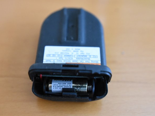

  1. How to fix Genie Intellicode Garage Remote Control battery issues, Acquire a battery holder: passo 1, immagine 1 di 1
    • The battery is a 12 volt alkaline battery, part number 23A or A23 among others. Buy a matching battery holder. I got some from one of the numerous major online stores.
