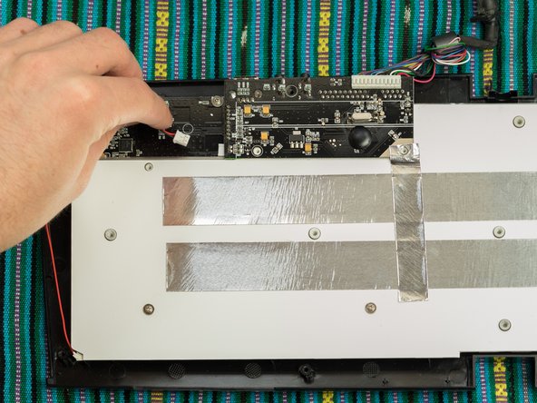

  1. How to disassemble for cleaning, Unscrew the back plate: passo 1, immagine 1 di 3 How to disassemble for cleaning, Unscrew the back plate: passo 1, immagine 2 di 3 How to disassemble for cleaning, Unscrew the back plate: passo 1, immagine 3 di 3
    • Remove 10 screws (8mm) securing the back plate.
    • Remove 4 screws (7mm, ball head) securing the handrest plate.
  2. How to disassemble for cleaning, Remove the handrest plate: passo 2, immagine 1 di 1
    • Lift the handrest plate and pull it free, away from the rest of the unit.
  3. How to disassemble for cleaning, Remove the back plate: passo 3, immagine 1 di 2 How to disassemble for cleaning, Remove the back plate: passo 3, immagine 2 di 2
    • After unscrewing, the back plate is now loose, and can be lifted gently to separate it.
    • Lift up the primary cable to free it from the casing.

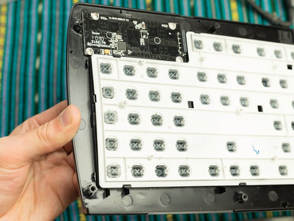

  4. How to disassemble for cleaning, Unscrew the membrane layers: passo 4, immagine 1 di 3 How to disassemble for cleaning, Unscrew the membrane layers: passo 4, immagine 2 di 3 How to disassemble for cleaning, Unscrew the membrane layers: passo 4, immagine 3 di 3
    • Remove 9 screws (5mm) that are securing the membrane layers.
    • Remove the plastic holder but retain it in a safe place, as it is used to restrict the data cable from moving freely and will need to be returned.
    • Gently pull the data cable (black/red) to disconnect it.

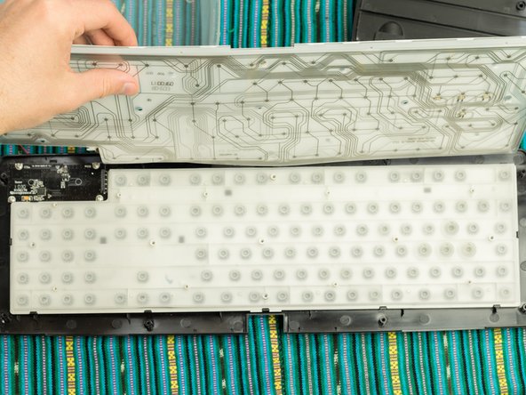

  5. How to disassemble for cleaning, Lift the membrane layers: passo 5, immagine 1 di 3 How to disassemble for cleaning, Lift the membrane layers: passo 5, immagine 2 di 3 How to disassemble for cleaning, Lift the membrane layers: passo 5, immagine 3 di 3
    • Start to gently remove the membrane cover, peeling off the layers beneath it as well.
    • Caution: take care not to damage the striped grey data cables, which connect all the layers.
  6. How to disassemble for cleaning, Remove the plastic membrane: passo 6, immagine 1 di 1
    • Peel off the plastic membrane.

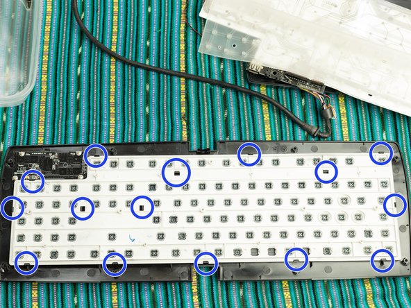

  7. How to disassemble for cleaning, Separating the front plate: passo 7, immagine 1 di 3 How to disassemble for cleaning, Separating the front plate: passo 7, immagine 2 di 3 How to disassemble for cleaning, Separating the front plate: passo 7, immagine 3 di 3
    • Push with moderate force to separate the keyframe (beige) from the front plate (black).
    • You should apply pressure at each hook (marked in blue).
    • Optional: prior to completing this step, remove all keycaps from the frame (Step 9). This may make it easier for you to apply pressure to the board, with less fear of breakage from undue force.

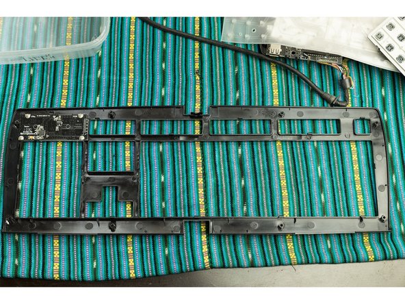

  8. How to disassemble for cleaning, Separated frame and front plate: passo 8, immagine 1 di 3 How to disassemble for cleaning, Separated frame and front plate: passo 8, immagine 2 di 3 How to disassemble for cleaning, Separated frame and front plate: passo 8, immagine 3 di 3
    • Photos.
