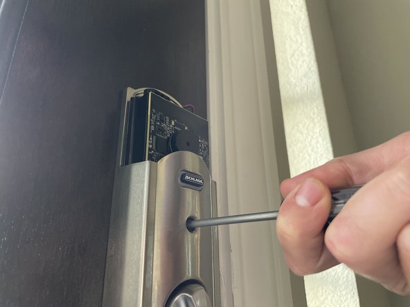

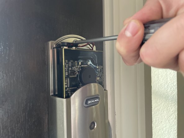

  3. How to Reset Your Schlage Connect to Factory Settings: passo 3, immagine 1 di 2 How to Reset Your Schlage Connect to Factory Settings: passo 3, immagine 2 di 2
    • Using a Phillips #0 screwdriver, remove the bottom screw and top screw.

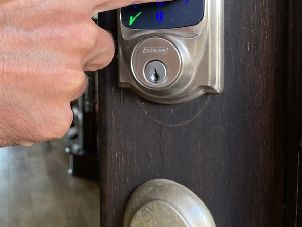

  9. How to Reset Your Schlage Connect to Factory Settings: passo 9, immagine 1 di 3 How to Reset Your Schlage Connect to Factory Settings: passo 9, immagine 2 di 3 How to Reset Your Schlage Connect to Factory Settings: passo 9, immagine 3 di 3
    • Press the Schlage button and continue pressing while at the same time reconnecting the battery.
    • You should see three green check marks on the lock's face.
