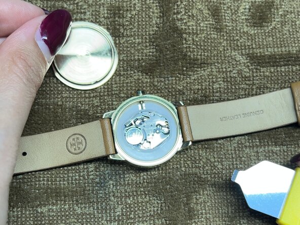

    6. How to Replace the Battery in a Tory Burch “Gigi” Wristwatch: passo 6, immagine 1 di 2 How to Replace the Battery in a Tory Burch “Gigi” Wristwatch: passo 6, immagine 2 di 2
      • Place the back cover back so it aligns with the snapback notch, next to the watch band.

    7. How to Replace the Battery in a Tory Burch “Gigi” Wristwatch: passo 7, immagine 1 di 1
      • Press the back cover firmly along the edges until it clicks into place.
