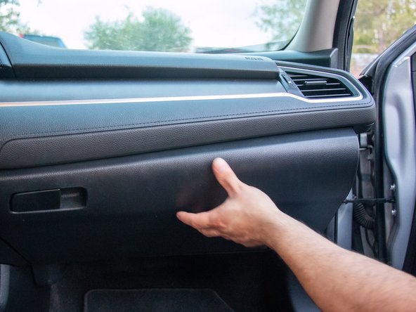

    • Direct your attention to the glove compartment directly in front of the front passenger seat.

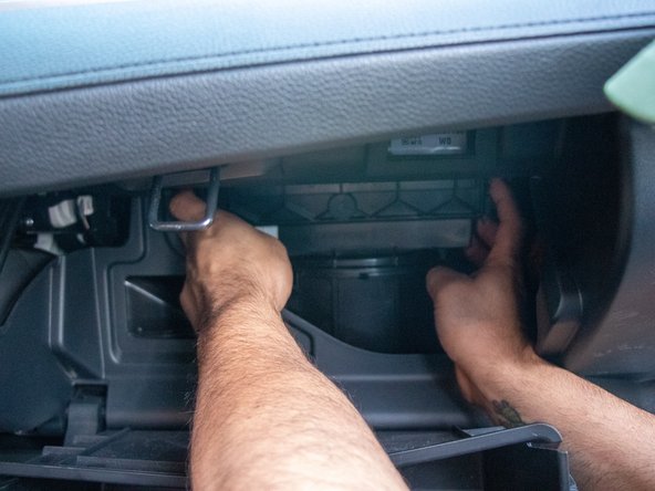

    • Open the glove compartment using the handle on the left-hand side.
    • It will open slightly towards you.
    • If you have any items in the glove compartment, remove them and set them aside.

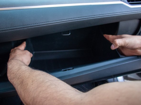

    • Reach inside the glove compartment and press on the two outer walls on each side of the storage box.
    • Lower the glove compartment down to the ground.

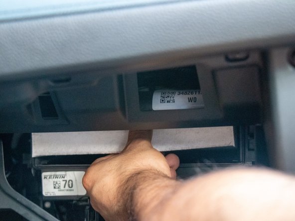

    • Reach into the space behind where the storage box previously rested and pull out the black, plastic panel with raised hexagonal lines.
    • This is the cover for the cabin air filter.

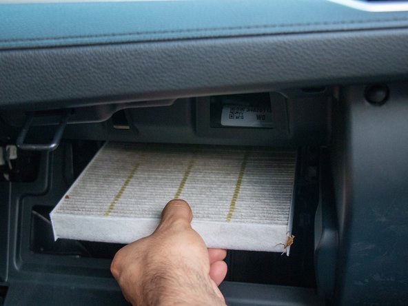

    • Pull out the cloth air filter from the space behind the air filter cover.
    • Dispose of the old air filter.
