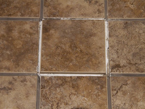

    • Use a painter's tool or putty knife to remove the grout from around the cracked tile.
    • Using an edge or corner of your painter's tool or putty knife, scrape the grout along the perimeter of the broken tile.
    • Be careful not to crack or scratch surrounding tiles.

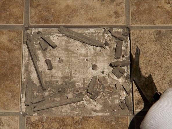

    • Remove the broken pieces of tile, using gloved hands for large pieces or a broom for smaller shards.
    • Using the painter's tool or putty knife, scrape the grout from the edges of tile and any adhesive from under the tile.
    • Be careful of sharp shards of tile.

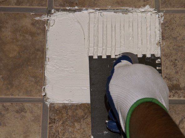

    • Apply new adhesive using the trowel, making sure the adhesive is spread evenly.
    • Drag the toothed end of the trowel across the adhesive to create even rows.
    • Quickly remove any adhesive from the surrounding tiles using a wet sponge or old rag, working quickly as the adhesive will begin to dry.

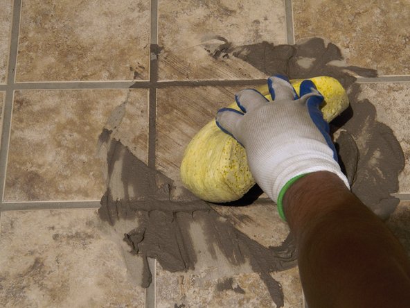

    • After the adhesive has dried, add water to a small amount of grout until it's the consistency of toothpaste.
    • Fill in the area around the new tile, making sure the new grout matches the height of the surrounding grout.
    • Use a moist sponge to wipe diagonally across the tile, cleaning off excess grout after each wipe.
