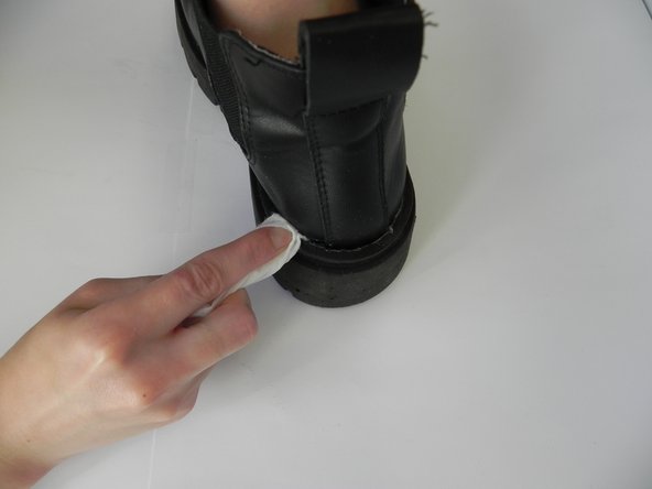

  1. How to Repair the Sole of a Heeled Shoe, How to Repair the Sole of a Heeled Shoe: passo 1, immagine 1 di 1
    • Use sanitizing wipes to clean any debris in the tear of the sole.
