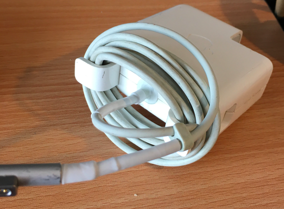

The Apple AC adapter cable often starts to fray/separate near where the cable meets the power brick. This guide shows how to repair it cleanly while maintaining the original look of your AC adapter.
Alternatively, you can follow this guide to replace the cord instead of repairing it.
  1. How to Repair an Apple AC Adapter Broken Cable, How to Repair an Apple AC Adapter Broken Cable: passo 1, immagine 1 di 1
    • The first thing you'll need, is to have managed to break the cable of your MagSafe Adapter.
    Done, that was the easiest part.

    Closing the case was a pain: the wings springs must get precisely on place. That was one of the most difficult part.
    And finally, as I explained in step 9 shrink the sleeves on both sides of the cable: Magsafe and Power supply.
    michel.firholz - Replica
    @karinamurphy:
    Always leave a loop before winding the cable along the wings.
    Just a view on the power supply repaired with shrink sleeves and the right way to wind the cable around the wings:
    Magsafe PS repaired
