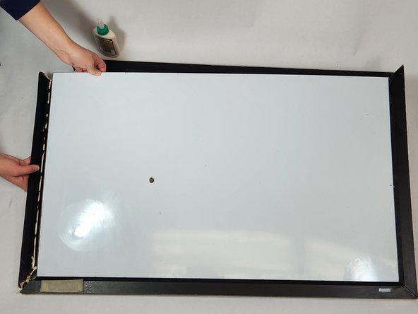

    • Gather all your tools which are listed in the tool area.
  2. How to Repair a Whiteboard Frame: passo 2, immagine 1 di 2 How to Repair a Whiteboard Frame: passo 2, immagine 2 di 2

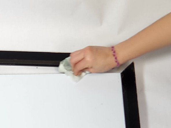

    • Start by applying Goo Gone onto a paper towel to remove any sticky residue from the outside of the whiteboard.

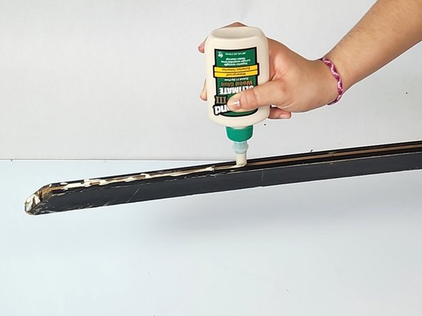

  4. How to Repair a Whiteboard Frame: passo 4, immagine 1 di 3 How to Repair a Whiteboard Frame: passo 4, immagine 2 di 3 How to Repair a Whiteboard Frame: passo 4, immagine 3 di 3
    • Apply an even amount of glue to each piece, then place them into position and wipe off any excess glue

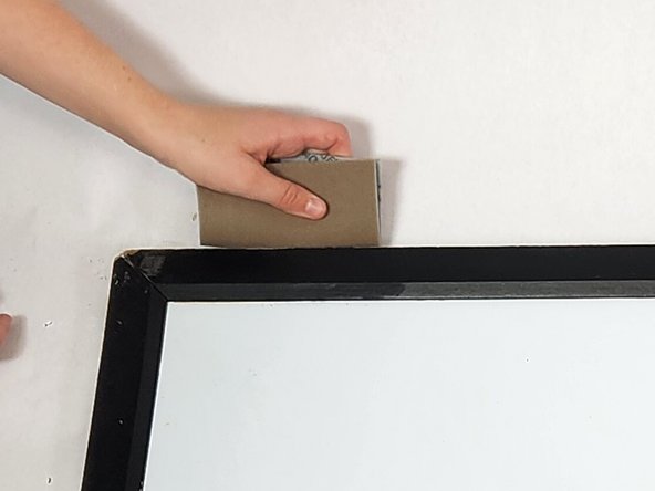

  8. How to Repair a Whiteboard Frame: passo 8, immagine 1 di 2 How to Repair a Whiteboard Frame: passo 8, immagine 2 di 2
    • After 24 hours, remove the clamps and sand down any rough corners if necessary.
