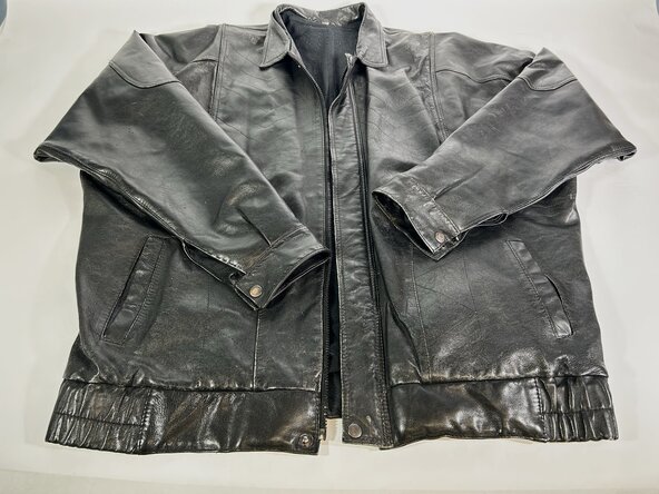

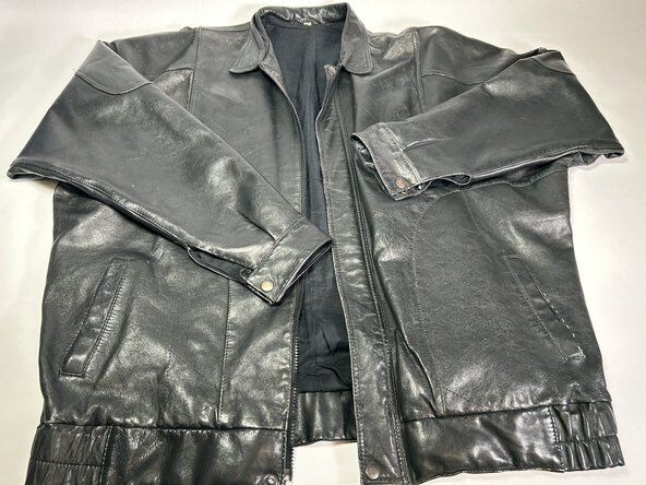

  1. How to Repair a Leather Jacket Pocket, How to Repair a Leather Jacket Pocket: passo 1, immagine 1 di 3 How to Repair a Leather Jacket Pocket, How to Repair a Leather Jacket Pocket: passo 1, immagine 2 di 3 How to Repair a Leather Jacket Pocket, How to Repair a Leather Jacket Pocket: passo 1, immagine 3 di 3
    • Lay the jacket flat and gather your scissors, needle, and thread.
    • If your jacket has a thicker material, you may consider using a thicker leather needle.
    • Be careful not to prick your fingers with the sharp tools listed above.

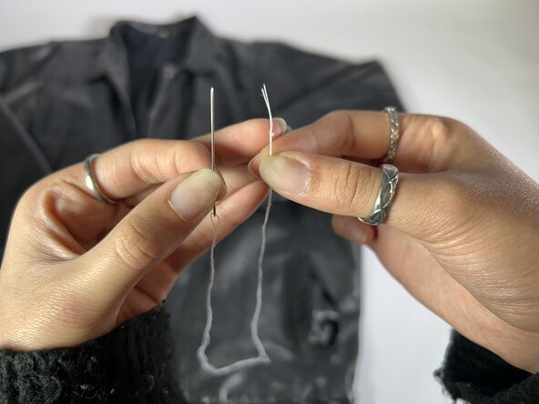

  2. How to Repair a Leather Jacket Pocket: passo 2, immagine 1 di 2 How to Repair a Leather Jacket Pocket: passo 2, immagine 2 di 2
    • Insert thread inside the eye of the needle.
    • Measure thread out to two times the length that you need and then use scissors to cut the thread.
    • We used white thread for this guide, but any color of thread will work for this project.

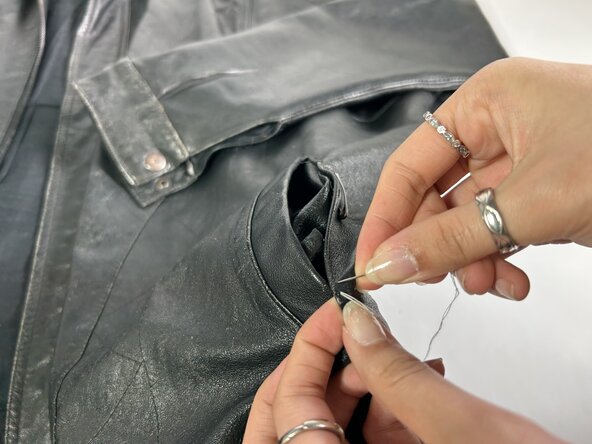

  4. How to Repair a Leather Jacket Pocket: passo 4, immagine 1 di 3 How to Repair a Leather Jacket Pocket: passo 4, immagine 2 di 3 How to Repair a Leather Jacket Pocket: passo 4, immagine 3 di 3

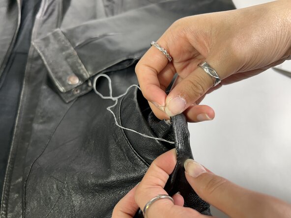

    • At the end of the tear, insert the needle inside of the fabric's right side and pull to tighten.
    • Then, insert the needle through the front of the fabric and pull to tighten to make your first stitch.
    • You can use a safety pin to hold your fabric together if needed.

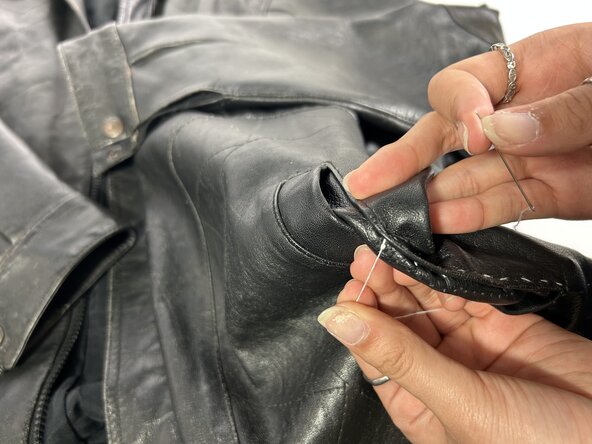

  5. How to Repair a Leather Jacket Pocket: passo 5, immagine 1 di 2 How to Repair a Leather Jacket Pocket: passo 5, immagine 2 di 2

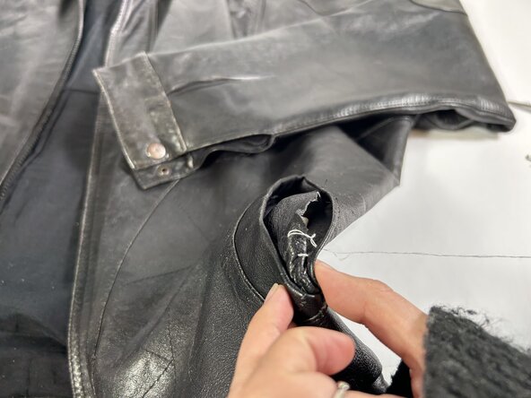

    • Now that your thread is facing the inside of the fabric, insert your needle into the first layer of the left side of the fabric.
    • Weave your needle up and out through this layer and pull to tighten.
    • The thread should not be visible on the outside of the left fabric.
  6. How to Repair a Leather Jacket Pocket: passo 6, immagine 1 di 3 How to Repair a Leather Jacket Pocket: passo 6, immagine 2 di 3 How to Repair a Leather Jacket Pocket: passo 6, immagine 3 di 3

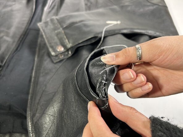

    • Insert your needle into the inside of the right side of the fabric and pull to tighten. This completes your first stitch.
  7. How to Repair a Leather Jacket Pocket: passo 7, immagine 1 di 2 How to Repair a Leather Jacket Pocket: passo 7, immagine 2 di 2

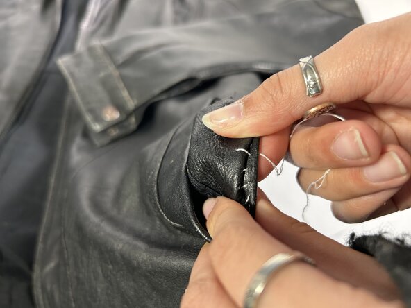

    • To start your next stitch, insert the needle 1cm above the last puncture.
    • Repeat steps 4 through 6 until you reach the end of your tear.

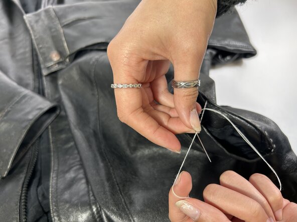

    • To finish the stitch, tie a knot by crossing the remaining thread on top of each other to make an X shape.
    • Loop the top thread inside the hole and use your thumb to hold the thread in place.
    • Make sure your needle and thread are on the inside of your fabric, or else the final knot will be visible on the outside.

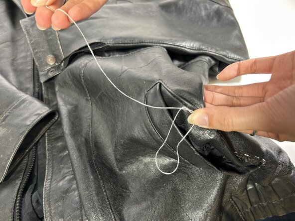

    • Pull the needle to tighten the knot as close to the last stitch as you can. Repeat the knot 3 times in the same spot.

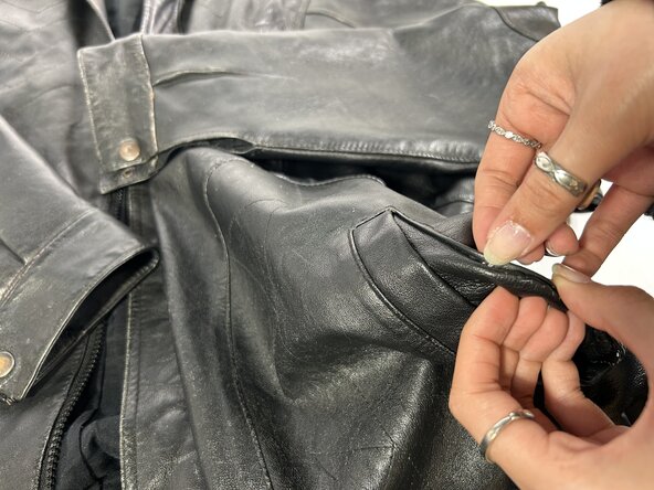

  10. How to Repair a Leather Jacket Pocket: passo 10, immagine 1 di 2 How to Repair a Leather Jacket Pocket: passo 10, immagine 2 di 2
    • Trim the remaining thread with scissors.
    • Tuck any remaining visible thread inside the fabric.
    • You may also use a needle to tuck in the remaining visible thread.
  11. How to Repair a Leather Jacket Pocket: passo 11, immagine 1 di 2 How to Repair a Leather Jacket Pocket: passo 11, immagine 2 di 2
    • Wear your newly-repaired leather jacket!
