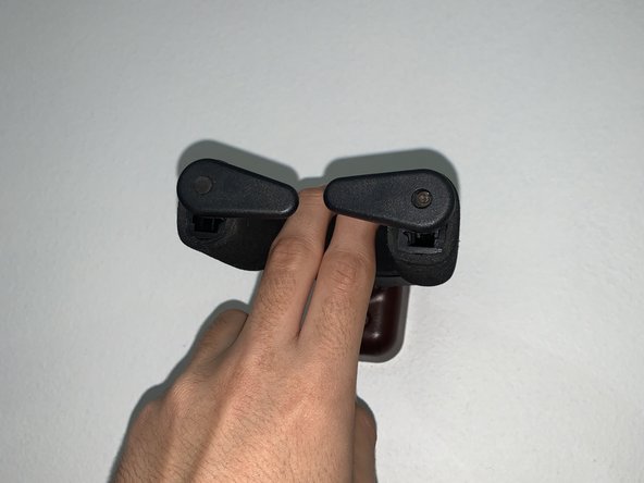

    • If the swivel mechanism on the arm of your guitar wall mount is hanging down and isn't responding to pressure, odds are the arm has become disengaged from the gears.

  6. How to Repair a Guitar Wall Mount: passo 6, immagine 1 di 3 How to Repair a Guitar Wall Mount: passo 6, immagine 2 di 3 How to Repair a Guitar Wall Mount: passo 6, immagine 3 di 3
    • Make sure the arms swivel appropriately with pressure and without pressure.
Conclusione
Screw your mount back onto the wall, and you're good-to-go!
