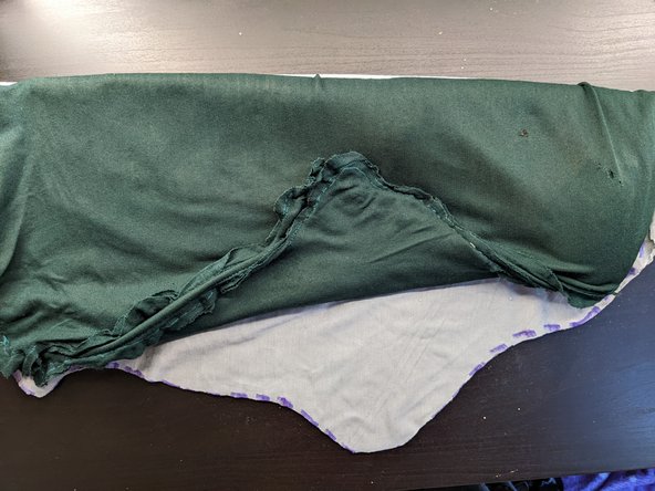

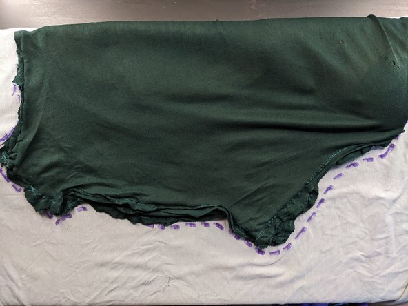

    • Fold the inside-out casing in half.
    • Place it on a piece of fabric folded into fourths. The loose ends of the fabric should be facing you.
    • Trace the outline of the casing with a marker.
  5. How to Reinforce a Microbead Plush: passo 5, immagine 1 di 2 How to Reinforce a Microbead Plush: passo 5, immagine 2 di 2
    • Use scissors to cut out the outline of the plush.
    • You may use safety pins on the inside of the outline so the fabric doesn't slip.
    • You can use the casing as a guide if you're unsure with your outline.

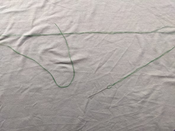

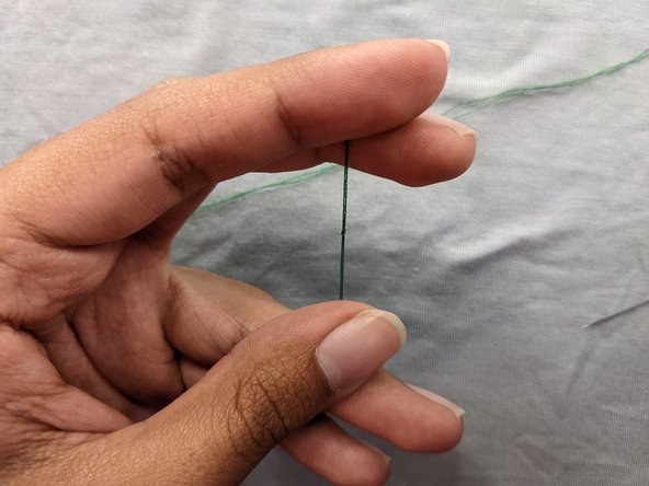

    • Measure about 20 times the length of the plush in thread.
    • Push the thread through the eye of the needle until both sides of the needle have an equal amount of thread.
    • Check out Repairing a Stuffed Teddy if you're unsure how to thread a needle.
    • Create a small loop using the loose ends, leaving about 2 centimeters to wrap around the base of the loop. Push the excess through the loop to create a knot.

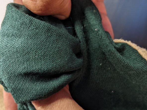

    • Unfold the material keeping both outline sheets together.
    • This will create a bag for the microbeads to go in.
    • After unfolding, use a different color marker to note where the hole made in step one is on your plush.
    • Do not close this hole as this is the refilling point.

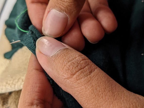

    • Start stitching along the edge of the outlines, weaving the needle every centimeter to close any gaps.

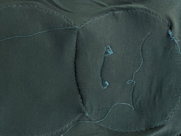

    • Stuff the bag into the plush, leaving the openings together.
    • Sew the edges of the openings onto the plush to prevent the bag from slipping when refilling.
    • Insert the funnel in the opening and begin refiling the plush.
    • Refill the plush slowly using a cup to avoid spilling the microbeads over the plush.
  9. How to Reinforce a Microbead Plush: passo 9, immagine 1 di 3 How to Reinforce a Microbead Plush: passo 9, immagine 2 di 3 How to Reinforce a Microbead Plush: passo 9, immagine 3 di 3
    • After refilling the plush, sew the opening closed.
    • After closing the opening press down on the plush to spread around the microbeads.
