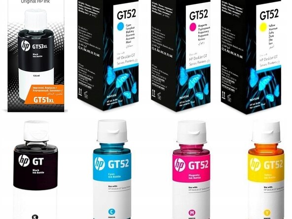

    • Make sure the printer is turned on. Place it on a flat surface covered with paper towels or cloth in case of ink spills. Prepare the correct HP ink bottles for your printer model (black, cyan, magenta, and yellow).

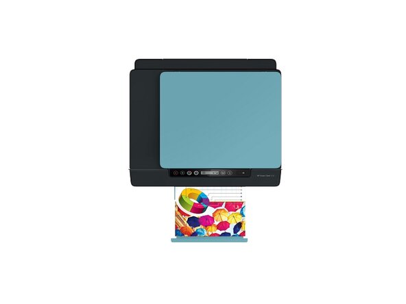

  1. How to Refill Ink in HP Smart Tank 516 Printer, Open the ink tank cover: passo 2, immagine 1 di 1
    • Open the ink tank cover

    • Shake the ink bottle gently (do not squeeze it hard). Remove the bottle cap and the inner seal, then screw the bottle tip back on.
    • Refill the tank Insert the bottle’s nozzle into the tank opening — it should fit securely. The ink will start flowing automatically; no squeezing is needed. Wait until the ink stops flowing, then remove the bottle and close its cap tightly.
