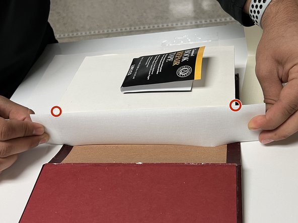

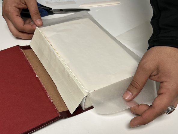

  2. How to Reattach a Cover to a Hardcover Book: passo 2, immagine 1 di 3 How to Reattach a Cover to a Hardcover Book: passo 2, immagine 2 di 3 How to Reattach a Cover to a Hardcover Book: passo 2, immagine 3 di 3
    • Cut a strip of wax paper a little longer than the length of the spine (about half an inch) with your scissors.
    • Set the wax paper into the hollow of the spine.
    • The wax paper should lay flat in the hollow to protect the inner cover of your book.

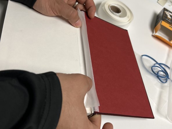

  3. How to Reattach a Cover to a Hardcover Book: passo 3, immagine 1 di 2 How to Reattach a Cover to a Hardcover Book: passo 3, immagine 2 di 2
    • Cut a length of book repair tape a little longer than the length of the spine (about half an inch) with your scissors.
    • The book repair tape needs to be about twice the width of the spine of the book. If your book repair tape meets this requirement, skip to Step 9. If your book repair tape is not wide enough, continue with Steps 4 - 8.

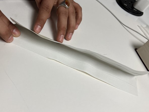

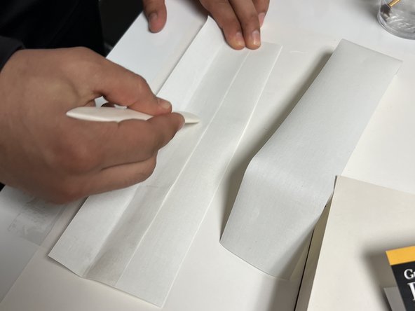

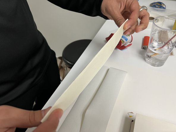

  4. How to Reattach a Cover to a Hardcover Book: passo 4, immagine 1 di 3 How to Reattach a Cover to a Hardcover Book: passo 4, immagine 2 di 3 How to Reattach a Cover to a Hardcover Book: passo 4, immagine 3 di 3
    • Cut two more lengths of book repair tape the same length as the first (about half an inch longer than the spine of your book).
    • Fold one piece of book repair tape lengthwise (hot dog style). The gummed side of the tape should be on the outside of the fold.
    • Book repair tape has two sides. One is gummed (covered in glue), and one is not. The gummed side will be slightly yellow and darker than the non-gummed side.

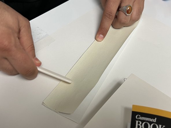

  5. How to Reattach a Cover to a Hardcover Book: passo 5, immagine 1 di 1
    • Set the folded piece of book repair tape flat onto the table.
    • Wet your paint brush with water.
    • Gently moisten one gummed side of the folded book repair tape with your paintbrush. This activates the glue.
    • Be careful not to oversaturate the tape. There should be no excess water, but all areas of the tape should be moist.

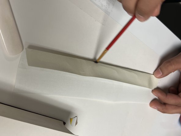

  6. How to Reattach a Cover to a Hardcover Book: passo 6, immagine 1 di 2 How to Reattach a Cover to a Hardcover Book: passo 6, immagine 2 di 2
    • Lift the folded book repair tape up by the edges using your fingers.
    • Press the moistened side of the tape down on the bottom half of the non-gummed side of your second piece of book repair tape.
    • Press and smooth the two pieces together using the bone folder.
    • Allow two to three minutes to dry.

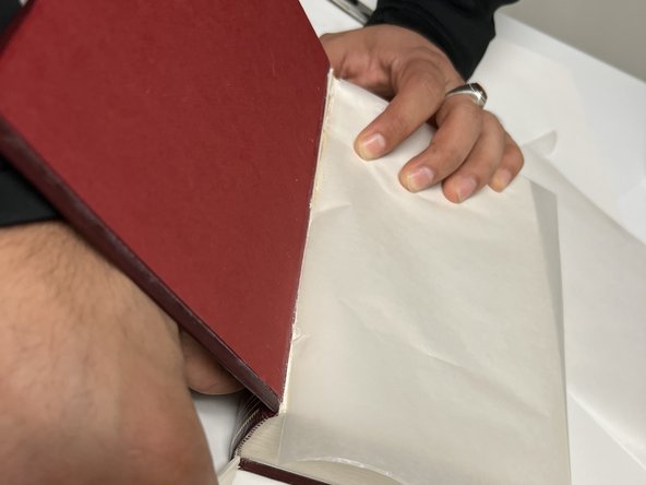

  15. How to Reattach a Cover to a Hardcover Book: passo 15, immagine 1 di 2 How to Reattach a Cover to a Hardcover Book: passo 15, immagine 2 di 2
    • Reopen the book.
    • Remove the wax strip from the hollow of the spine.
    • Trim the excess book repair tape with your scissors.
    • Trim as close to the spine of your book as you can.

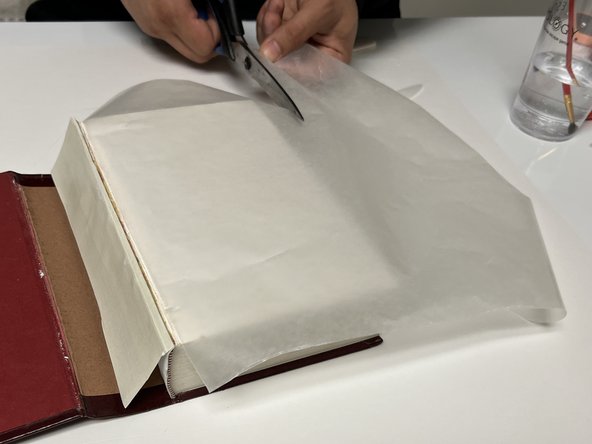

  16. How to Reattach a Cover to a Hardcover Book: passo 16, immagine 1 di 3 How to Reattach a Cover to a Hardcover Book: passo 16, immagine 2 di 3 How to Reattach a Cover to a Hardcover Book: passo 16, immagine 3 di 3
    • Cut a large piece of wax paper to sufficiently cover the pages of your book.
    • Place the wax paper over the pages of your book to protect it.

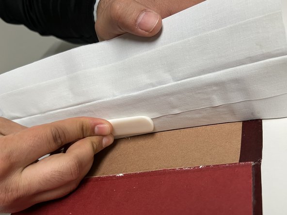

  18. How to Reattach a Cover to a Hardcover Book: passo 18, immagine 1 di 3 How to Reattach a Cover to a Hardcover Book: passo 18, immagine 2 di 3 How to Reattach a Cover to a Hardcover Book: passo 18, immagine 3 di 3
    • Hold the book repair tape down with one hand.
    • Press the other edge of the book repair tape down towards the spine with the bone folder.
    • Push the detached cover towards the spine to attach it to the book repair tape.

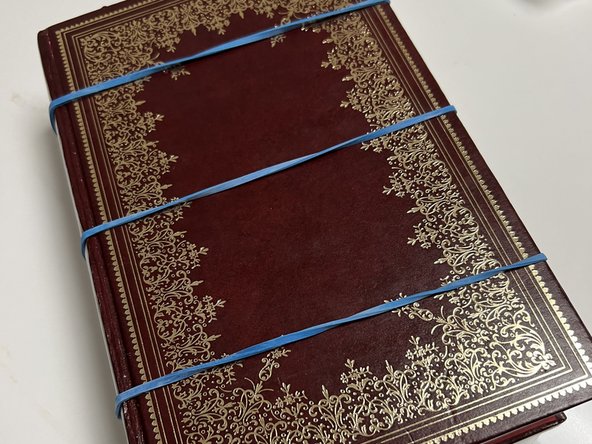

  21. How to Reattach a Cover to a Hardcover Book: passo 21, immagine 1 di 3 How to Reattach a Cover to a Hardcover Book: passo 21, immagine 2 di 3 How to Reattach a Cover to a Hardcover Book: passo 21, immagine 3 di 3
    • Hold the book firmly shut.
    • Wrap a rubber band around the top, middle, and bottom of your book to secure it.
    • Let the book settle with the rubber bands for 24 hours.
    • Remove the wax paper after the book has settled for at least 24 hours.
