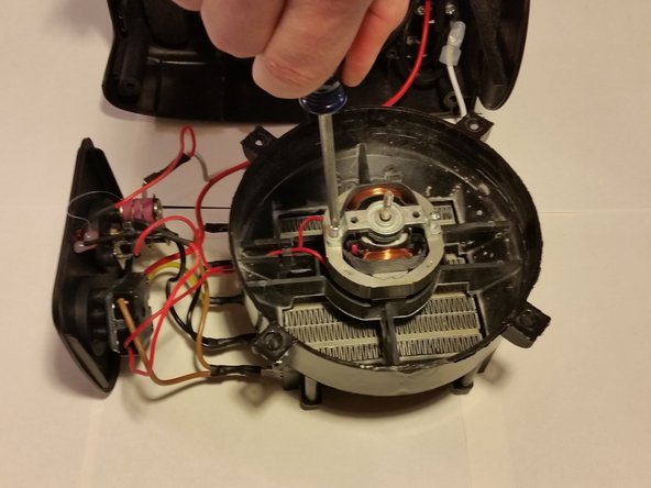

    • Slightly loosen both of the motor retainer screws about one full rotation.
  8. How to Realign the Motor in a Space Heater: passo 8, immagine 1 di 1
    • Push down on the motor bracket and adjust the motor by hand so it spins freely and does not scrape.

  11. How to Realign the Motor in a Space Heater: passo 11, immagine 1 di 2 How to Realign the Motor in a Space Heater: passo 11, immagine 2 di 2
    • Press the safety switch briefly to confirm that the motor can spin. Slightly tighten the screws and adjust the motor's alignment by hand until it can spin freely. A light rattling or noise is fine and will be fixed later.
    • Keep your fingers clear of the motor while it is spinning.

  13. How to Realign the Motor in a Space Heater: passo 13, immagine 1 di 2 How to Realign the Motor in a Space Heater: passo 13, immagine 2 di 2
    • While the motor is running, slowly tighten the retainer screws until the motor runs smoothly and quietly.
    • If the screws are too loose, the motor will rattle or screech. If the screws are too tight, the motor cannot turn.
