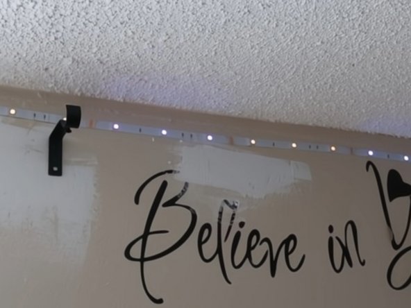

  1. How to Install a Curtain Rod On a Damaged Wall Using Drywall Anchors, How to Install a Curtain Rod On a Damaged Wall Using Drywall Anchors: passo 1, immagine 1 di 1
    • Use a scraper to apply the drywall compound to the damaged drywall and fill in the holes.
  2. How to Install a Curtain Rod On a Damaged Wall Using Drywall Anchors: passo 2, immagine 1 di 1
    • Let it dry for up to 3 days to ensure that the drywall compound sets properly.
    • If using spackle, 1 day is sufficient drying time.

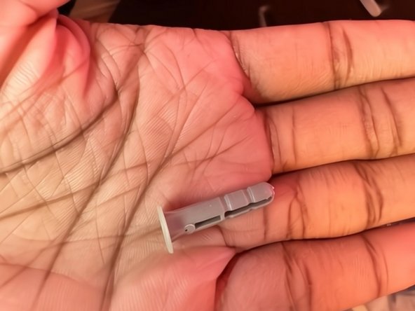

  4. How to Install a Curtain Rod On a Damaged Wall Using Drywall Anchors: passo 4, immagine 1 di 2 How to Install a Curtain Rod On a Damaged Wall Using Drywall Anchors: passo 4, immagine 2 di 2
    • Drill a hole that is slightly smaller than the drywall anchor.
    • Then, use a hammer to gently tap the anchor into the wall.
    • Caution: Be careful of your hands and fingers.
