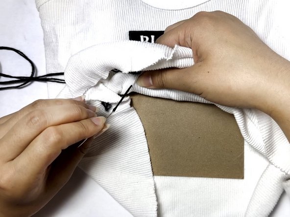

    • Place the cardboard separator in between the layers of your chosen garment.
    • This helps to avoid stitching both sides of the garment together.

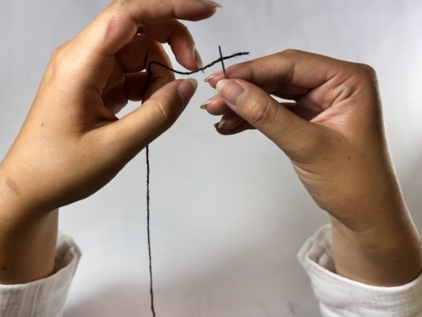

  4. How to Hand Sew Patches Onto a Garment: passo 4, immagine 1 di 2 How to Hand Sew Patches Onto a Garment: passo 4, immagine 2 di 2
    • Push the thread through the eye of the needle.
    • To prevent fraying, twist the ends of the thread to tighten it.

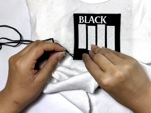

  5. How to Hand Sew Patches Onto a Garment: passo 5, immagine 1 di 3 How to Hand Sew Patches Onto a Garment: passo 5, immagine 2 di 3 How to Hand Sew Patches Onto a Garment: passo 5, immagine 3 di 3
    • Insert the needle through the backside of the shirt and patch.
    • Pull the needle until the thread is taut.
    • Insert the needle through the outside of the shirt and patch, at the length you’d like your stitch to be.
    • Pull the needle again until the thread is taut.

  7. How to Hand Sew Patches Onto a Garment: passo 7, immagine 1 di 3 How to Hand Sew Patches Onto a Garment: passo 7, immagine 2 di 3 How to Hand Sew Patches Onto a Garment: passo 7, immagine 3 di 3
    • Lace the needle through the extra fabric of the shirt that is covered by the patch.
    • Hold both ends of your thread and rotate it around the needle twice.
    • Create a loop using the thread and pull your needle through the loop.
    • Pull until the knot has formed (no extra thread is leftover).
    • Cut the thread with 1-2 inches to spare.

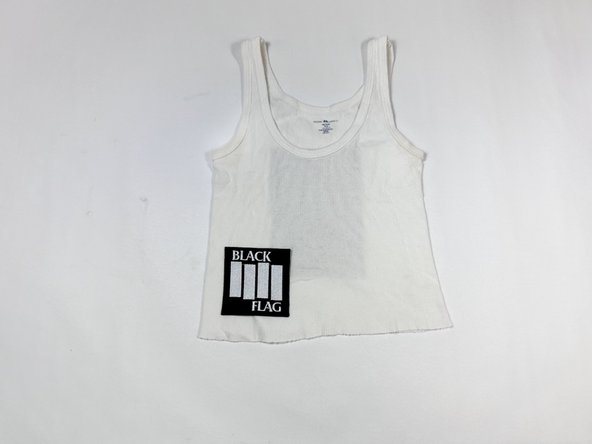

  8. How to Hand Sew Patches Onto a Garment: passo 8, immagine 1 di 1
    • Finished Product!
