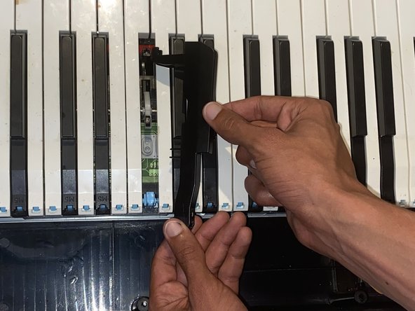

    • Unclip each key that is stuck or needs repair and pull it off the board carefully.
    • You may need to use tweezers to push down the small blue clip on one end while you pry up the opposite end of the key.

    • Check the underside of the key(s) for a build-up of dust, dirt, or crumbs, and brush it off using an anti-static brush.

    • Check that the hammer (gray piece) and clip (blue piece) are in line with each other.
    • Every hammer should have a corresponding small, black rubber pad on top.
    • If the rubber pad is loose, misaligned, or falling off, it is important to superglue it back into place similar to how the other key pads look.

    • Use your fingers to carefully bend the key alignments until they are parallel with each other.

    • Clip the key back onto the keyboard by pressing down on each end, one at a time.
    • This method will ensure that you can hear and feel each key end clip into place correctly.
