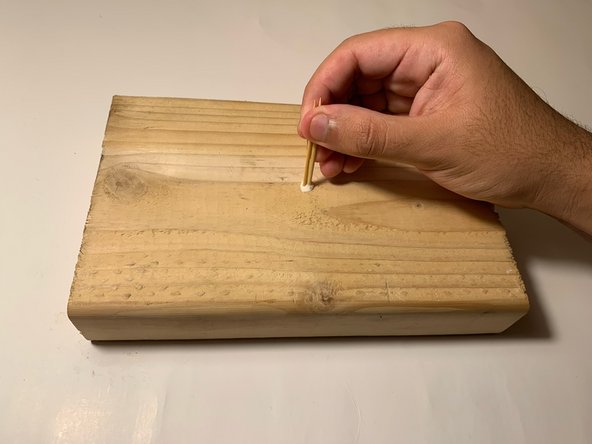

    • Next, using the wood glue, cover the area of the toothpick(s) that will fill in the screw hole.
  3. How to Fix A Stripped Screw Hole: passo 3, immagine 1 di 2 How to Fix A Stripped Screw Hole: passo 3, immagine 2 di 2
    • Place the toothpicks into the screw hole.
  4. How to Fix A Stripped Screw Hole: passo 4, immagine 1 di 1
    • Now, break off the exposed segment of the toothpick(s).
  5. How to Fix A Stripped Screw Hole: passo 5, immagine 1 di 1
    • Clean off the excess and let the wood glue dry for up to 30 minutes.
    • Recommended wood glue drying time may vary by product.

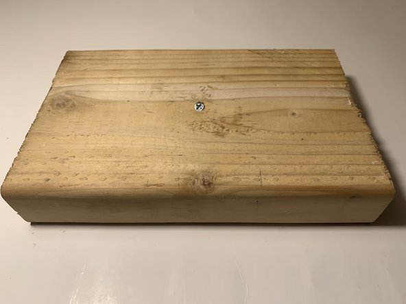

  6. How to Fix A Stripped Screw Hole: passo 6, immagine 1 di 2 How to Fix A Stripped Screw Hole: passo 6, immagine 2 di 2
    • Finally, using the screwdriver, screw the screw into the repaired screw hole.
Conclusione
Your screw should now hold secure.
