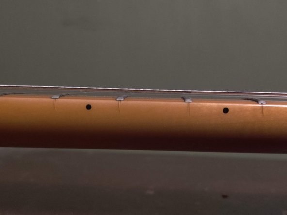

    • Locate the truss rod, found either on the headstock, under a plate in the headstock, or on the body towards the base of the neck.
  2. How to Adjust the Action and Intonation of a Guitar: passo 2, immagine 1 di 3 How to Adjust the Action and Intonation of a Guitar: passo 2, immagine 2 di 3 How to Adjust the Action and Intonation of a Guitar: passo 2, immagine 3 di 3
    • As you adjust the truss rod, listen for fret buzz or dead spots. These usually create a sound that rings out less than it should. Keep adjusting until the guitar reaches its best tone.
    • For humped necks, loosen the truss rod by turning the Allen wrench counterclockwise. For bowed necks, tighten the truss rod by turning the Allen wrench clockwise.
    • Use an Allen wrench that can adjust the truss rod.
    • TAKE THIS STEP SLOWLY. To make small adjustments, turn the allen wrench a quarter of a turn at a time, checking the neck regularly.
