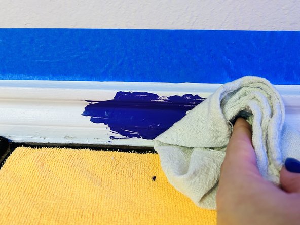

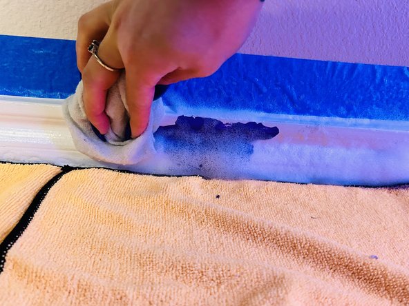

  2. How To Repair A Paint Stained Baseboard: passo 2, immagine 1 di 3 How To Repair A Paint Stained Baseboard: passo 2, immagine 2 di 3 How To Repair A Paint Stained Baseboard: passo 2, immagine 3 di 3
    • Clean the baseboard with a solution of mild detergent and a clean wet cloth.
    • For stubborn stains or greasy areas, use wood cleaner or mineral spirits.
    • Wipe the baseboard dry with a clean cloth.

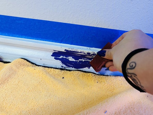

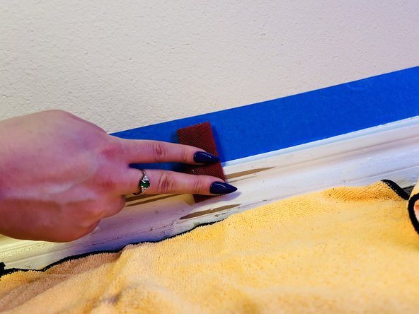

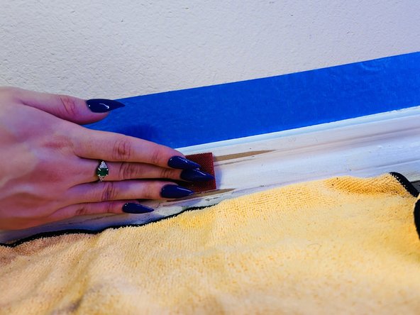

  3. How To Repair A Paint Stained Baseboard: passo 3, immagine 1 di 3 How To Repair A Paint Stained Baseboard: passo 3, immagine 2 di 3 How To Repair A Paint Stained Baseboard: passo 3, immagine 3 di 3
    • If the paint stain is raised or thick, use a putty knife or paint scraper to gently scrape off as much of the old paint as possible without damaging the wood underneath.
    • If using rubber gloves, put them on after using the paint scraper or putty knife.
    • Use 120-grit sandpaper to sand the stained area, smoothing out any rough edges and removing the remaining paint.
    • Sand in the direction of the wood grain.

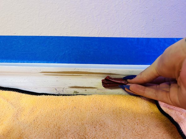

  4. How To Repair A Paint Stained Baseboard: passo 4, immagine 1 di 3 How To Repair A Paint Stained Baseboard: passo 4, immagine 2 di 3 How To Repair A Paint Stained Baseboard: passo 4, immagine 3 di 3
    • Use 220-grit sandpaper to smooth the area further, blending it seamlessly with the surrounding surface.
    • This will help remove any fine scratches caused by the coarser sandpaper.
    • If the scraping or sanding has created any dents or gouges in the baseboard, apply wood filler with a putty knife to fill these areas.
    • Allow the wood filler to dry according to the manufacturer’s instructions, then sand it smooth with 220-grit sandpaper.

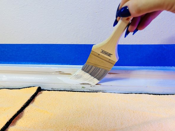

  5. How To Repair A Paint Stained Baseboard: passo 5, immagine 1 di 3 How To Repair A Paint Stained Baseboard: passo 5, immagine 2 di 3 How To Repair A Paint Stained Baseboard: passo 5, immagine 3 di 3
    • Use a paint brush to apply a coat of primer to the sanded and repaired area to ensure the paint adheres well.
    • Use a small paintbrush to apply paint to the repaired area, ensuring an even coat. Select a paint that matches the existing color of the baseboard for a seamless finish.
    • Apply a thin, even coat and let it dry completely before applying additional coats if necessary.

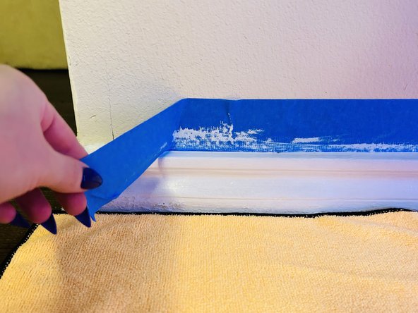

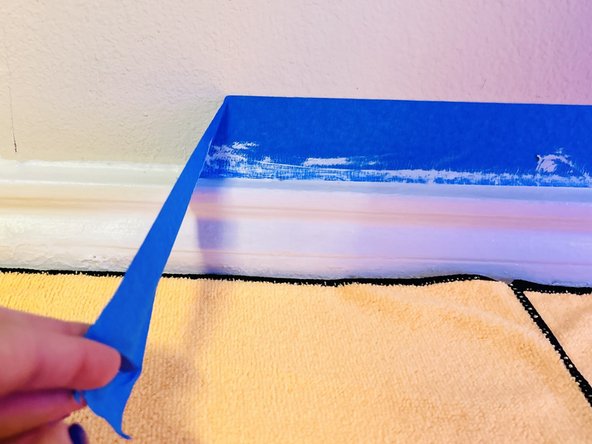

  6. How To Repair A Paint Stained Baseboard: passo 6, immagine 1 di 3 How To Repair A Paint Stained Baseboard: passo 6, immagine 2 di 3 How To Repair A Paint Stained Baseboard: passo 6, immagine 3 di 3
    • Once the paint is dry, carefully remove the painter’s tape.
    • Pull the tape at a 45-degree angle to avoid pulling off any paint.

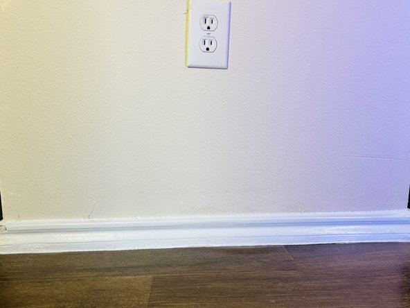

  8. How To Repair A Paint Stained Baseboard: passo 8, immagine 1 di 3 How To Repair A Paint Stained Baseboard: passo 8, immagine 2 di 3 How To Repair A Paint Stained Baseboard: passo 8, immagine 3 di 3
    • Check the repaired area to ensure it blends seamlessly with the rest of the baseboard.
    • Touch up any imperfections as needed.
