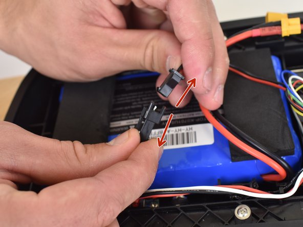

  3. Hover-1 Coast Power Button Spring Replacement: passo 3, immagine 1 di 3 Hover-1 Coast Power Button Spring Replacement: passo 3, immagine 2 di 3 Hover-1 Coast Power Button Spring Replacement: passo 3, immagine 3 di 3
    • The battery is connected by these two sets of wires.
    • Remove the yellow wire first by pulling the two wires gently in opposite directions.
    • Now pull apart the black wire by gently pulling the two wires in opposite directions.

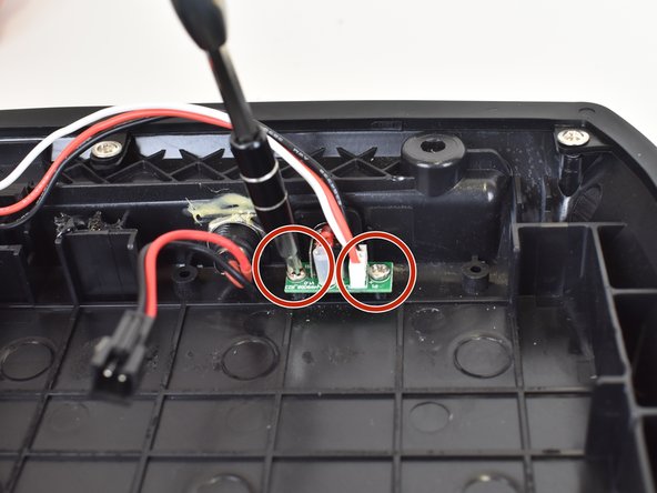

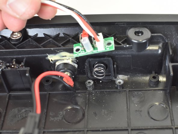

  5. Hover-1 Coast Power Button Spring Replacement, Power Button Spring: passo 5, immagine 1 di 3 Hover-1 Coast Power Button Spring Replacement, Power Button Spring: passo 5, immagine 2 di 3 Hover-1 Coast Power Button Spring Replacement, Power Button Spring: passo 5, immagine 3 di 3
    • Using the Phillips #1 screwdriver, loosen the two screws and place the power button somewhere safe.

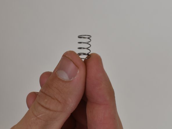

  6. Hover-1 Coast Power Button Spring Replacement: passo 6, immagine 1 di 2 Hover-1 Coast Power Button Spring Replacement: passo 6, immagine 2 di 2
    • Remove the unwanted spring and place your new spring back into the hole.
