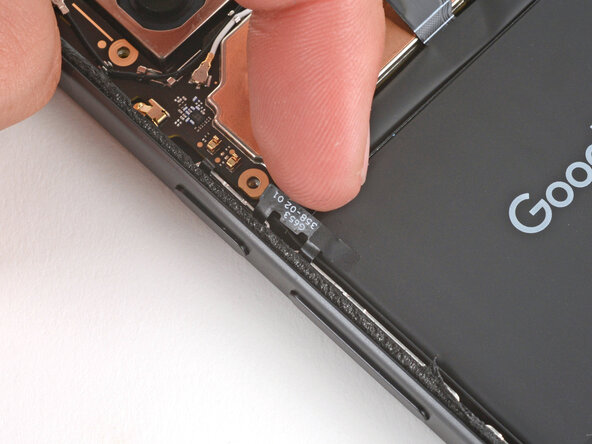

    • The side button cable is delicate—be careful not to damage it.
    • Use your fingernail or a spudger to gently peel up the side button cable and flip it over the side of your phone.
    • If you use a spudger, be very careful not to poke the battery.

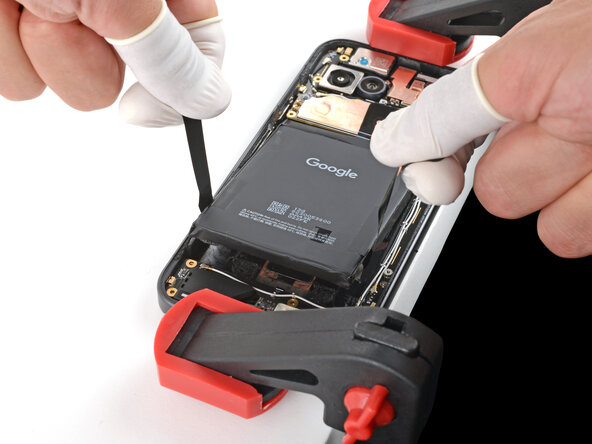

  20. Google Pixel 9a Battery Replacement, Secure the phone to your work surface: passo 20, immagine 1 di 2 Google Pixel 9a Battery Replacement, Secure the phone to your work surface: passo 20, immagine 2 di 2
    Attrezzo utilizzato in questo passaggio:
    Heavy-Duty F-Clamp
    $13.99
    • Since the battery pull tabs require two hands, you'll need to firmly secure the phone to your work surface.
    • Before securing your phone, clean the work surface, making sure nothing is under the screen.
    • Only secure the phone by the raised lip of the frame, and be very careful not to clamp down on any internal components.
    • Use F‑Clamps or C‑Clamps to secure the phone to your work surface. At minimum, you'll need two clamps—one for the top edge and one for the bottom edge.
    • Use clamps with plastic or rubber pads. If using metal clamps, place a cloth between the frame and the clamp to avoid marring the metal frame.
    • If you don't have any clamps, have a friend hold the phone firmly in place.
    • Make sure to follow ESD precautions when securing the phone.
  21. Google Pixel 9a Battery Replacement, Separate the battery adhesive: passo 21, immagine 1 di 3 Google Pixel 9a Battery Replacement, Separate the battery adhesive: passo 21, immagine 2 di 3 Google Pixel 9a Battery Replacement, Separate the battery adhesive: passo 21, immagine 3 di 3
    • Pull straight up on the battery pull tabs and apply constant, steady pressure until the battery separates from the frame. Don't yank on the tabs or the may rip.
    • If the battery doesn't separate after one minute of steady pressure, apply more heat and try again.
    • Remove the battery.
    • Never reuse a deformed or damaged battery—it's a fire hazard. Replace it with a new battery.
    • If you successfully removed the battery, congratulations! Skip down five steps for reassembly information.
    • If the pull tabs broke or accidentally slipped out from under the battery, don't worry! Go to the next step for an alternate battery removal method.

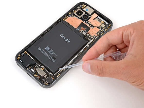

  22. Google Pixel 9a Battery Replacement, Apply isopropyl alcohol: passo 22, immagine 1 di 2 Google Pixel 9a Battery Replacement, Apply isopropyl alcohol: passo 22, immagine 2 di 2
    • During the next two steps, don't apply more isopropyl alcohol than instructed, or you may damage your screen.
    • Apply two or three drops of high-concentration (>90%) isopropyl alcohol to the top right and bottom right corners of the battery.
    • Wait one minute to allow the alcohol to soften the battery adhesive.

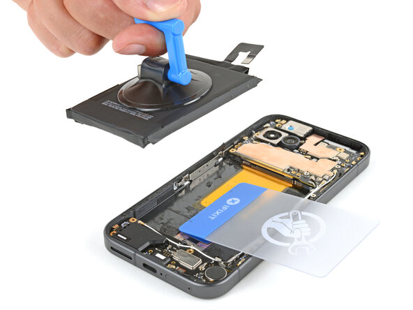

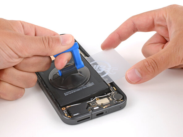

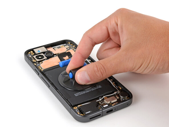

  23. Google Pixel 9a Battery Replacement, Apply a suction handle to the battery: passo 23, immagine 1 di 3 Google Pixel 9a Battery Replacement, Apply a suction handle to the battery: passo 23, immagine 2 di 3 Google Pixel 9a Battery Replacement, Apply a suction handle to the battery: passo 23, immagine 3 di 3
    • Apply a suction handle to the center of the battery, so the vertical arm is facing the right edge.
    • Insert the short edge of a plastic card between the right edge of the battery and the logic board, so the card is near the upper section of the battery.

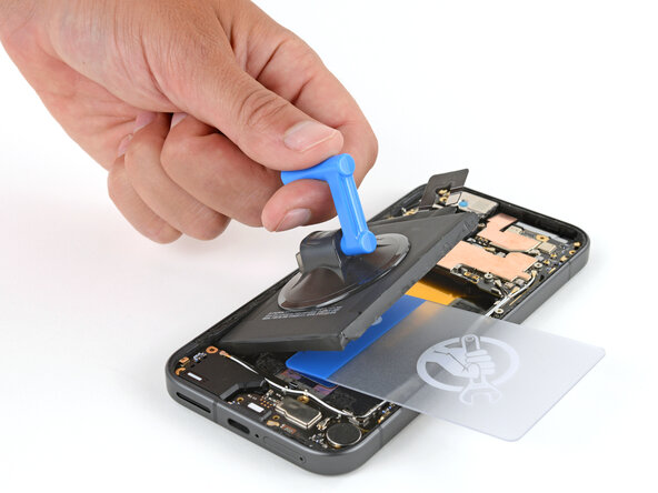

  24. Google Pixel 9a Battery Replacement, Separate the battery adhesive: passo 24, immagine 1 di 3 Google Pixel 9a Battery Replacement, Separate the battery adhesive: passo 24, immagine 2 di 3 Google Pixel 9a Battery Replacement, Separate the battery adhesive: passo 24, immagine 3 di 3
    • Pull up on the suction handle with strong, steady force and pry up with the plastic card until it slides under the battery.
    • It takes time and constant pressure to get the plastic card under the battery.
    • Continue pulling up on the suction handle and slide the plastic card fully under the battery to separate its adhesive.
  25. Google Pixel 9a Battery Replacement, Remove the battery: passo 25, immagine 1 di 3 Google Pixel 9a Battery Replacement, Remove the battery: passo 25, immagine 2 di 3 Google Pixel 9a Battery Replacement, Remove the battery: passo 25, immagine 3 di 3
    • Use the suction handle to lift and remove the battery.

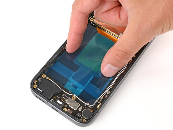

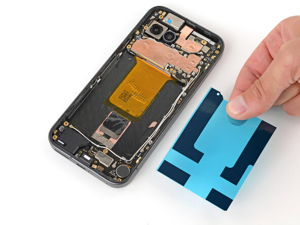

  29. Google Pixel 9a Battery Replacement, Apply the battery adhesive: passo 29, immagine 1 di 3 Google Pixel 9a Battery Replacement, Apply the battery adhesive: passo 29, immagine 2 di 3 Google Pixel 9a Battery Replacement, Apply the battery adhesive: passo 29, immagine 3 di 3
    • Remove the larger, clear liner from your replacement battery adhesive.
    • Lay the adhesive into the battery recess so the strips align with their contours on the frame.

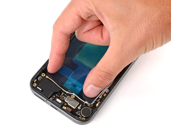

  30. Google Pixel 9a Battery Replacement: passo 30, immagine 1 di 3 Google Pixel 9a Battery Replacement: passo 30, immagine 2 di 3 Google Pixel 9a Battery Replacement: passo 30, immagine 3 di 3
    • Use your fingers or a spudger to firmly press the adhesive into place, securing it to the frame.

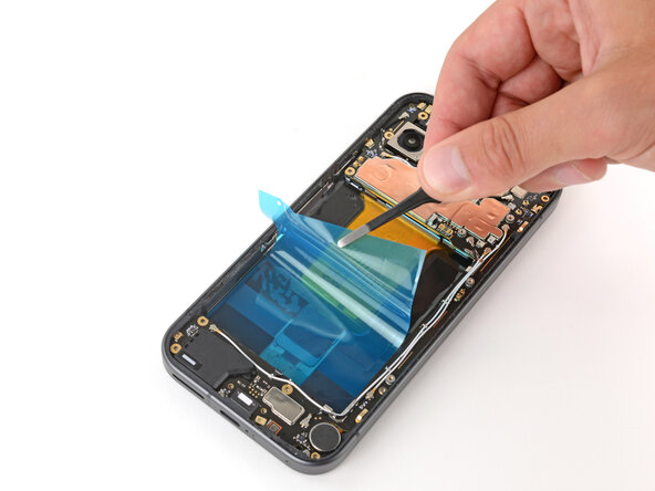

  31. Google Pixel 9a Battery Replacement, Remove the plastic liner: passo 31, immagine 1 di 3 Google Pixel 9a Battery Replacement, Remove the plastic liner: passo 31, immagine 2 di 3 Google Pixel 9a Battery Replacement, Remove the plastic liner: passo 31, immagine 3 di 3
    • Peel up and remove the remaining liner.

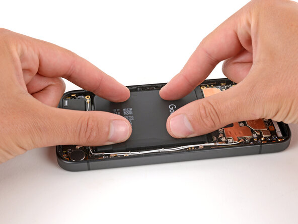

  32. Google Pixel 9a Battery Replacement, Move the side button cable: passo 32, immagine 1 di 1
    • Gently flip the side button cable over the frame so it doesn't get stuck between the side of the battery and the frame in the next step.
  33. Google Pixel 9a Battery Replacement, Install the battery: passo 33, immagine 1 di 3 Google Pixel 9a Battery Replacement, Install the battery: passo 33, immagine 2 di 3 Google Pixel 9a Battery Replacement, Install the battery: passo 33, immagine 3 di 3
    • Hold the battery above its recess and use your finger to push down and reconnect the battery press connector.
    • Temporarily reconnecting the battery ensures that it's sitting properly in its recess.
    • Lay the battery into its recess and press down firmly to secure it to the adhesive.
    • Once the battery's in place, disconnect it while you continue reassembly.

  37. Google Pixel 9a Battery Replacement, Secure the adhesive: passo 37, immagine 1 di 3 Google Pixel 9a Battery Replacement, Secure the adhesive: passo 37, immagine 2 di 3 Google Pixel 9a Battery Replacement, Secure the adhesive: passo 37, immagine 3 di 3
    • Use a spudger to firmly press down on each of the six pieces of inner housing adhesive to secure them.
    • These pieces of adhesive can easily be pulled up when removing the final liners, so make sure they're firmly in place.

  44. Google Pixel 9a Battery Replacement, Remove the old rear cover adhesive: passo 44, immagine 1 di 3 Google Pixel 9a Battery Replacement, Remove the old rear cover adhesive: passo 44, immagine 2 di 3 Google Pixel 9a Battery Replacement, Remove the old rear cover adhesive: passo 44, immagine 3 di 3
    • Take your time during the next two steps. A clean frame allows replacement adhesive to lay evenly, ensuring a better bond.
    • Use a spudger and tweezers to scrape up and remove all the old rear cover adhesive from the perimeter of your phone.
    • If you scrape up a piece big enough to grip with your fingers, you can pull long sections of the adhesive up. Pull slowly and straight in the opposite direction of the adhesive.
