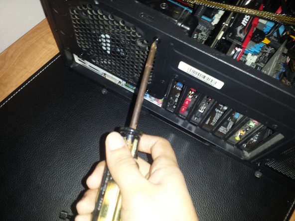

  1. Gaming PC CPU Cooler Replacement, Remove side panel of desktop: passo 1, immagine 1 di 1
    • Unplug the computer and any connecting cables before starting.
    • Remove the screws holding the side panel from the back side of the computer case.

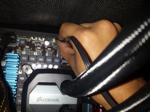

  2. Gaming PC CPU Cooler Replacement, Unscrew the cooler: passo 2, immagine 1 di 3 Gaming PC CPU Cooler Replacement, Unscrew the cooler: passo 2, immagine 2 di 3 Gaming PC CPU Cooler Replacement, Unscrew the cooler: passo 2, immagine 3 di 3
    • There is a cable connected to the cooler unplug it from the motherboard.
    • Unscrew the screws holding the cooler at the corners of the CPU.
    • Take out the cooler and place it at a reasonable location, underside up.
    • Remember the location of where the cable connected to the cooler is.

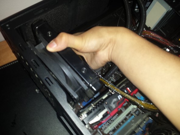

  3. Gaming PC CPU Cooler Replacement, Removing the radiator: passo 3, immagine 1 di 3 Gaming PC CPU Cooler Replacement, Removing the radiator: passo 3, immagine 2 di 3 Gaming PC CPU Cooler Replacement, Removing the radiator: passo 3, immagine 3 di 3
    • Find the location of the radiator and locate the screws holding it.
    • Remove the screws and being to hold both the radiator and fan as the last screw is coming off.
    • Remove the radiator and fan.

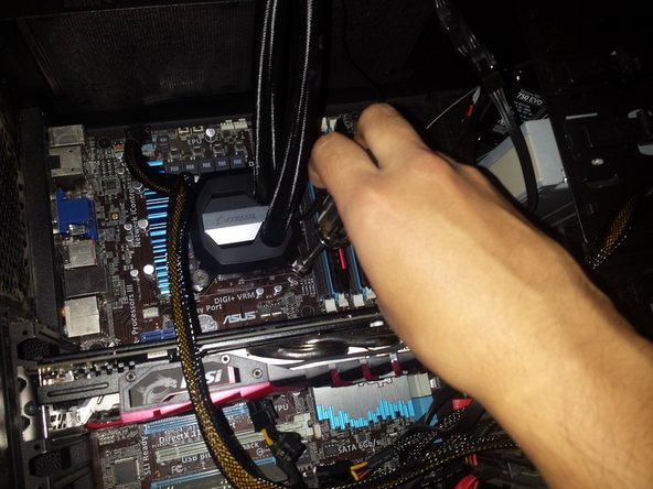

  5. Gaming PC CPU Cooler Replacement, Placing new cooler: passo 5, immagine 1 di 3 Gaming PC CPU Cooler Replacement, Placing new cooler: passo 5, immagine 2 di 3 Gaming PC CPU Cooler Replacement, Placing new cooler: passo 5, immagine 3 di 3
    • Place the new cooler over the cpu and align it with the four corners where the previous cooler was attached to.
    • Screw in the cooler, start at a corner and then move on to the corner diagonal from it, making an "X" shape as you screw them in.
    • It does not have to be tight, just as long as the cooler does not move, and both the cooler and CPU have proper contact with each other.
    • Plug in the power of the cooler in the same location of the previous cooler.

DO NOT put thermal paste on the cooler first, put it on the CPU directly then apply the cpu cooler onto the cpu and screw it down in X formation. Top left, bottom right, bottom left, top right, then tighten just a little at a time till it's finger tight with screw driver.
