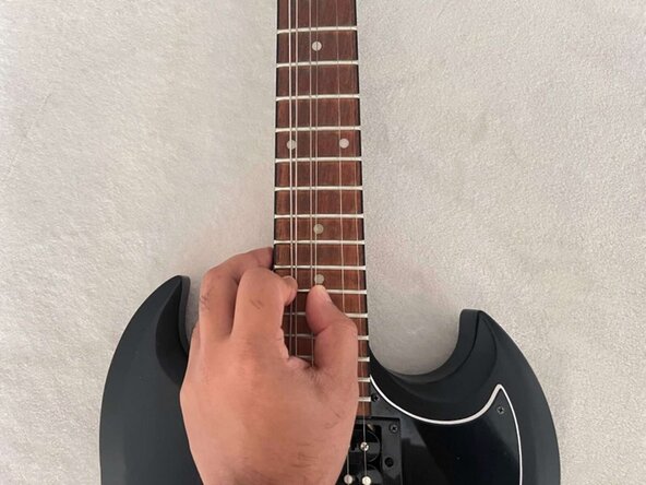

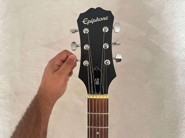

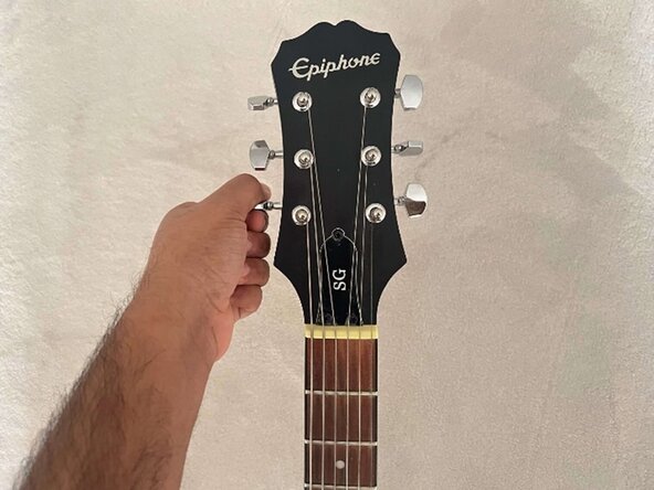

    • Twist each tuning peg in an anti-clockwise direction to tune down and release the tension on the strings.
    • Ensure your strings are loose before proceeding.
    • When you strum the strings, they should not vibrate.

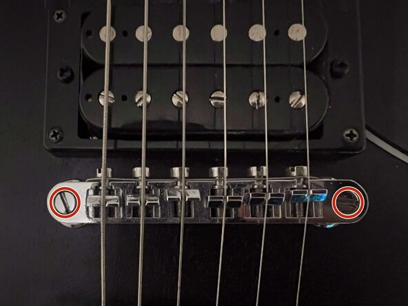

    • Be careful when handling the screws to avoid stripping them or damaging the surrounding area.
    • Use a 4.0 mm flathead screwdriver to remove two 20 mm screws from the bridge.

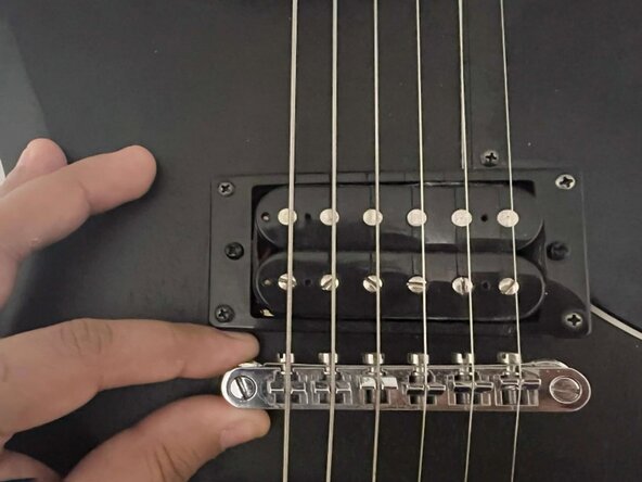

    • Replace the bushings below the bridge of the guitar.
    • Ensure the bushings are aligned properly to avoid any shifting.
    • Put the new bridge in place.
    • Use a 4.0 mm flathead screwdriver to securely tighten the 20 mm screws, ensuring the bridge is held firmly in place.
    • Do not over-tighten the screws, as this could damage the guitar.
    • Double-check that the bridge is aligned correctly and firmly attached.
