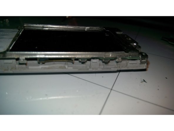

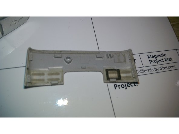

  4. Disassembling Nokia X2-00, Diging In! 2nd attemp!: passo 4, immagine 1 di 2 Disassembling Nokia X2-00, Diging In! 2nd attemp!: passo 4, immagine 2 di 2
    • i tried to remove the side panels but that didn't work so i tried on top and it did work (Jimmy worked fine)
    • these clips kind of suck ....it takes lot of force to unclip these )
    • after you unclip it you get that piece

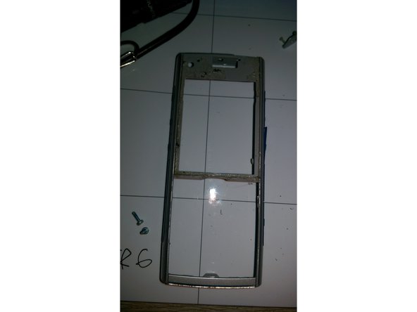

  5. Disassembling Nokia X2-00, Removing the midframe: passo 5, immagine 1 di 3 Disassembling Nokia X2-00, Removing the midframe: passo 5, immagine 2 di 3 Disassembling Nokia X2-00, Removing the midframe: passo 5, immagine 3 di 3
    • remove these 2 TR6 Screws (mine were a bit blue)
    • open it up (clips on the bottom)
    • i was on Beast-Mode on these annying clips that held like gorilla

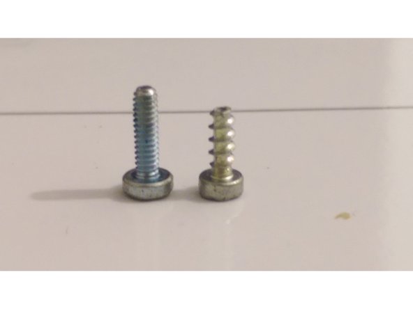

  6. Disassembling Nokia X2-00, Removing the display: passo 6, immagine 1 di 3 Disassembling Nokia X2-00, Removing the display: passo 6, immagine 2 di 3 Disassembling Nokia X2-00, Removing the display: passo 6, immagine 3 di 3
    • Remove the 4 TR6 Screws
    • They are diffrent from the last ones !!! (this one on the right)

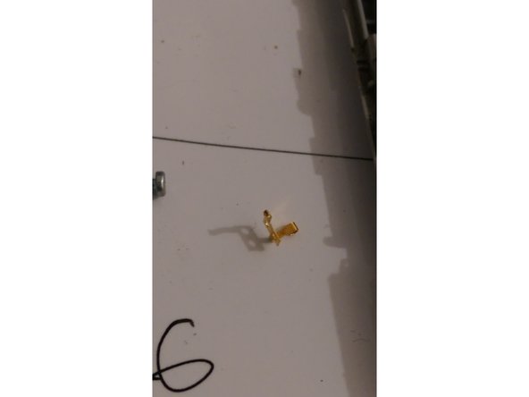

  9. Disassembling Nokia X2-00, Extra - Mastery pieces & Test: passo 9, immagine 1 di 2 Disassembling Nokia X2-00, Extra - Mastery pieces & Test: passo 9, immagine 2 di 2
    • extra steps that you don't need to do
    • 2 of those fell of and i have NO idea where from (and i don't even care)
