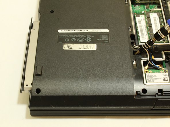

    • Locate the slot for the CD ROM ejector found inside the red box shown.
  5. Dell Latitude E5500 CD ROM Drive Replacement: passo 5, immagine 1 di 2 Dell Latitude E5500 CD ROM Drive Replacement: passo 5, immagine 2 di 2
    • Using a #2 Phillip's head screwdriver, push the CD ROM ejector to the left.
    • Once the CD ROM clicks out, carefully slide it out of the laptop.
Conclusione
To reassemble your device, follow these instructions in reverse order using your new CD Rom.
