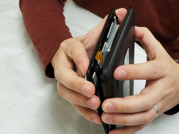

  3. Craig Electronics CMP773 Front and Rear Camera Replacement: passo 3, immagine 1 di 2 Craig Electronics CMP773 Front and Rear Camera Replacement: passo 3, immagine 2 di 2
    • Move the opening tool along the edge of the tablet to continue popping the casing loose.
    • Once the casing is about half loose, remove it by hand.

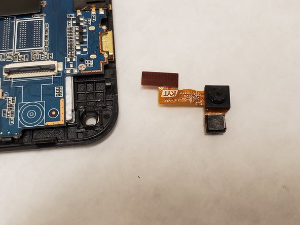

  6. Craig Electronics CMP773 Front and Rear Camera Replacement: passo 6, immagine 1 di 2 Craig Electronics CMP773 Front and Rear Camera Replacement: passo 6, immagine 2 di 2
    • Use the spudger to dislodge camera unit from the casing and remove it from the device.
