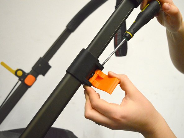

  1. Bugaboo Cameleon 1 and 3  Handlebar Clip Replacement, Remove old part: passo 1, immagine 1 di 2 Bugaboo Cameleon 1 and 3  Handlebar Clip Replacement, Remove old part: passo 1, immagine 2 di 2
    • Loosen the screw using the torx screwdriver.
    • Make sure to catch the nut that will fall out at the bottom, by holding the other hand underneath the clip.
    • Make sure not to lose the screw since you will need it later for the reassembly.
