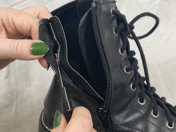

    • Using a seam ripper, carefully remove the stitching at the top of the boot on either side of the zipper.
    • Only remove enough to free the zipper, about ¾ of an inch.
  2. Boot Zipper Replacement: passo 2, immagine 1 di 3 Boot Zipper Replacement: passo 2, immagine 2 di 3 Boot Zipper Replacement: passo 2, immagine 3 di 3
    • Remove the stitching on the heel side of the zipper.
    • The stitches on the heel side connect four layers of material: the lining, the zipper underlay, the zipper, and the outer leather.
    • Work between the leather and the zipper by pulling apart the leather and zipper and inserting the seam ripper into the gap.

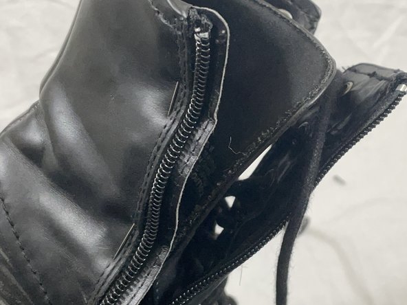

  4. Boot Zipper Replacement: passo 4, immagine 1 di 1
    • Remove any leftover thread.

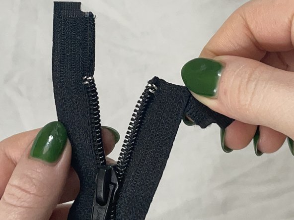

  6. Boot Zipper Replacement: passo 6, immagine 1 di 1
    • If your zipper is too long, trim it about an inch below your pin.
  7. Boot Zipper Replacement: passo 7, immagine 1 di 2 Boot Zipper Replacement: passo 7, immagine 2 di 2
    • Fold down the excess fabric at the top of the zipper twice to create a right angle.
  8. Boot Zipper Replacement: passo 8, immagine 1 di 3 Boot Zipper Replacement: passo 8, immagine 2 di 3 Boot Zipper Replacement: passo 8, immagine 3 di 3
    • Stitch in place.
    • Use pliers if the fabric is too thick to push the needle through easily.

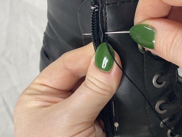

  9. Boot Zipper Replacement: passo 9, immagine 1 di 2 Boot Zipper Replacement: passo 9, immagine 2 di 2
    • Pin your new zipper to the outer leather on the heel side.
    • Be careful to put your pins through the existing holes in the leather to avoid damaging the leather further.
  10. Boot Zipper Replacement: passo 10, immagine 1 di 1
    • Using a backstitch, sew the zipper to the leather along the inner row of stitching.
    • Be careful to put your needle through the existing holes in the leather to avoid damaging the leather further.
