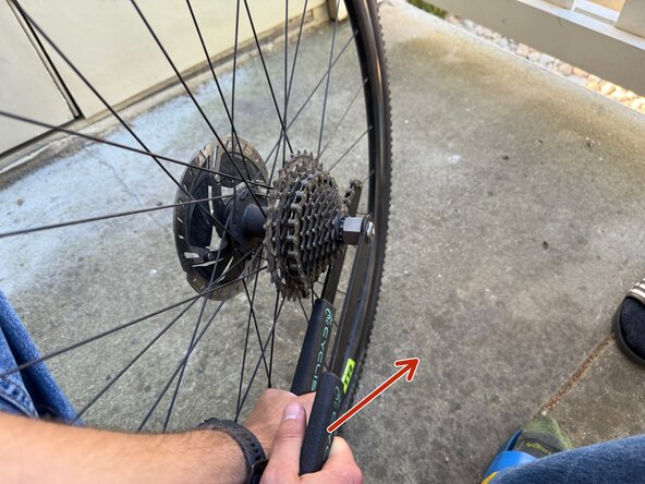

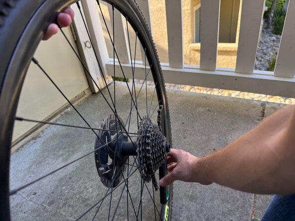

    • Place your wheel on a hard surface with the cassette on your right side.
    • Wrap the chain whip clockwise around the cassette.

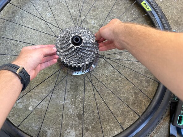

    • Insert the cassette lockring tool into the center of the cassette with the lever arm between 7 and 9 o'clock.
    • Holding the chain whip in place with your left hand, apply counterclockwise force on the cassette tool's lever arm.
    • Continue turning the cassette tool until the tool spins freely.

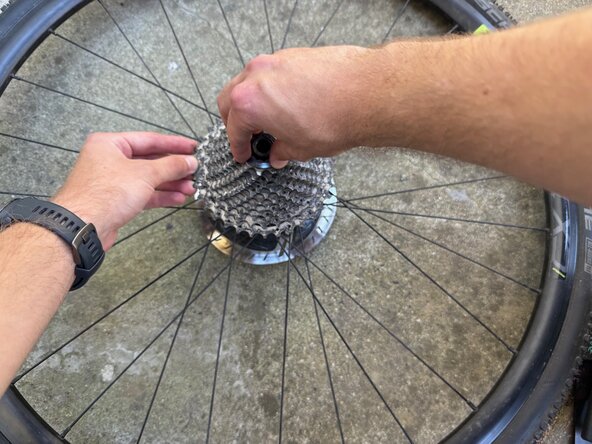

  3. Bicycle Cassette Replacement: passo 3, immagine 1 di 3 Bicycle Cassette Replacement: passo 3, immagine 2 di 3 Bicycle Cassette Replacement: passo 3, immagine 3 di 3

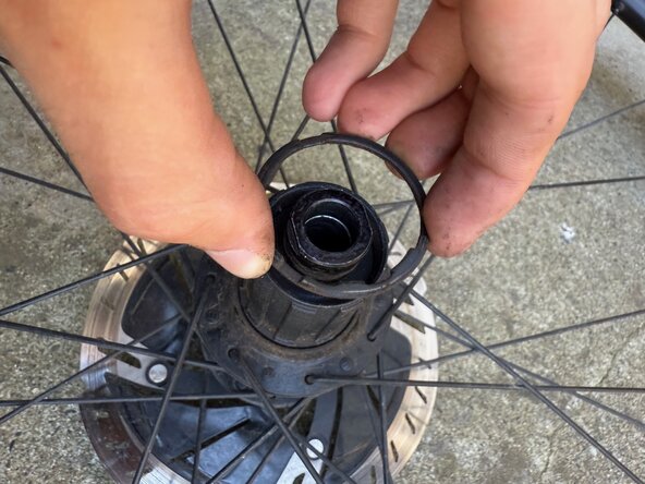

    • Lay the wheel down on a flat surface with the cassette facing upwards.
    • Loosen the cassette lockring by turning it counterclockwise.

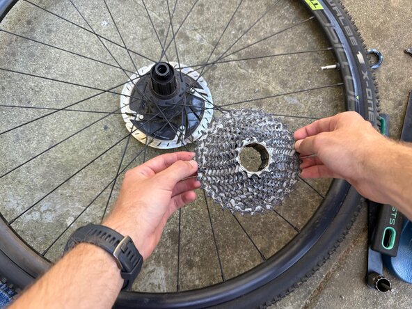

  4. Bicycle Cassette Replacement: passo 4, immagine 1 di 3 Bicycle Cassette Replacement: passo 4, immagine 2 di 3 Bicycle Cassette Replacement: passo 4, immagine 3 di 3

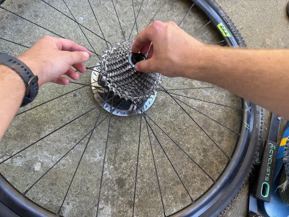

    • Remove the cassette lockring.
    • Using both hands, lift the cassette in one piece from the freehub body.

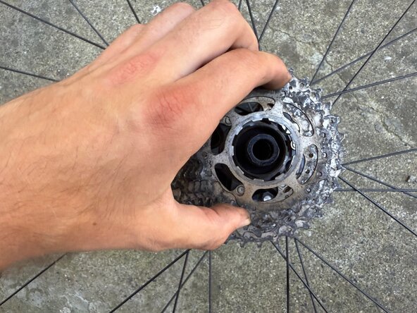

  5. Bicycle Cassette Replacement: passo 5, immagine 1 di 2 Bicycle Cassette Replacement: passo 5, immagine 2 di 2
    • Your cassette may require a spacer to work properly with your freehub. Consult your cassette user's manual to determine your spacer needs.
    • Remove the old freehub body spacer as needed.

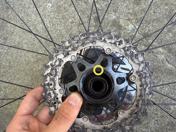

    • Locate the small cutout on the bottom of the new cassette.

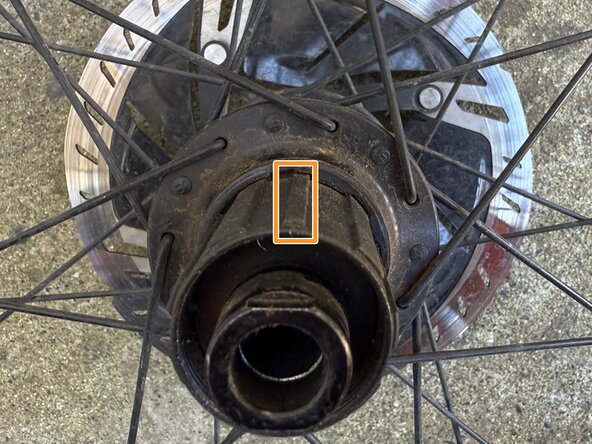

    • Locate the small ridge on the freehub body.
    • Slide the bottom piece of the new cassette on the freehub body by matching the small cutout with the small ridge.

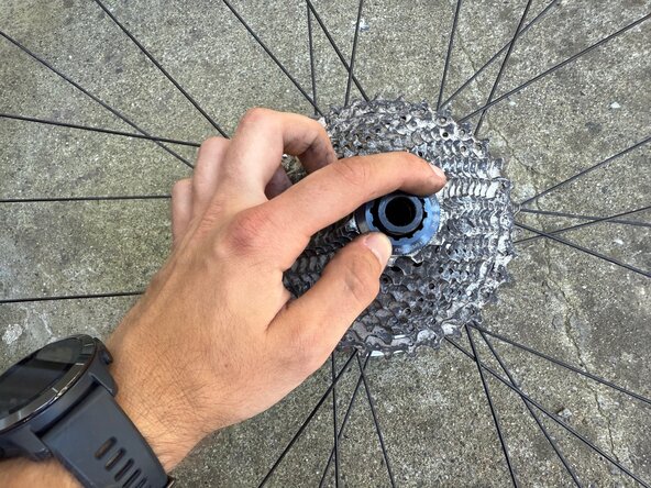

  8. Bicycle Cassette Replacement: passo 8, immagine 1 di 3 Bicycle Cassette Replacement: passo 8, immagine 2 di 3 Bicycle Cassette Replacement: passo 8, immagine 3 di 3
    • For the final two cogs, locate the small cutouts and place on top of the already placed cogs by aligning with the top of small ridge on the freehub body.
    • The top two cogs will not fully slide on to the freehub body and require more attention for aligned placement.

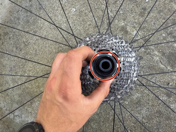

  9. Bicycle Cassette Replacement: passo 9, immagine 1 di 2 Bicycle Cassette Replacement: passo 9, immagine 2 di 2
    • Place the cassette lockring onto the top of the final cog.
    • Start threading the lockring clockwise into the freehub by hand.
