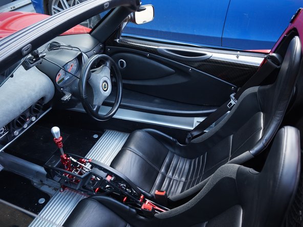

Beta Installation of AliTech Shifter
  1. Beta Installation of AliTech Shifter, Seatbelts & Seats: passo 1, immagine 1 di 3 Beta Installation of AliTech Shifter, Seatbelts & Seats: passo 1, immagine 2 di 3 Beta Installation of AliTech Shifter, Seatbelts & Seats: passo 1, immagine 3 di 3

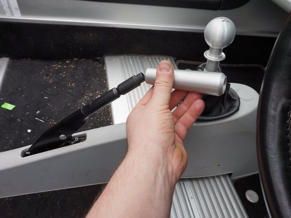

  3. Beta Installation of AliTech Shifter, Handbrake Trim: passo 3, immagine 1 di 2 Beta Installation of AliTech Shifter, Handbrake Trim: passo 3, immagine 2 di 2
    • Loosen the hex grub screws on the lower side of the handbrake trim.
    • The handbrake trim should now come away from the handbrake mechanism.

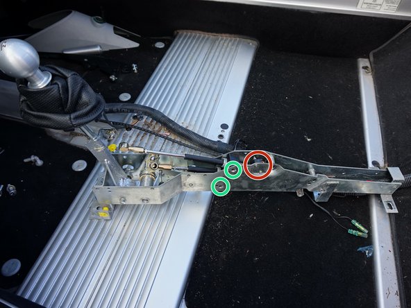

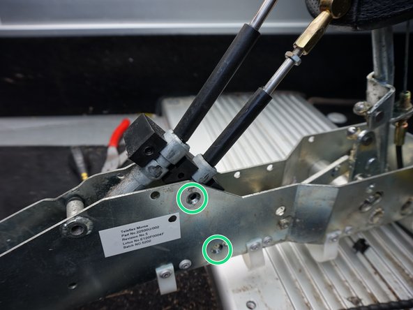

  5. Beta Installation of AliTech Shifter, Shifter & Handbrake Cables: passo 5, immagine 1 di 3 Beta Installation of AliTech Shifter, Shifter & Handbrake Cables: passo 5, immagine 2 di 3 Beta Installation of AliTech Shifter, Shifter & Handbrake Cables: passo 5, immagine 3 di 3
    • Detach the cable from the bottom of the handbrake.
    • Note: This can be made easier by removing the entire handbrake from the shifter unit.
    • You will need to remove the handbrake microswitch from the shifter. This will be fitted in a similar position on the AliTech shifter in Step 10.
    • Make sure the gearbox is in neutral before carrying out the following steps. This will aid in setting up the AliTech Shifter.
    • Remove the remaining bolts securing the front of the shifter to the car chassis
    • Undo the block holding the shifter cables in place. This is held with 4 screws - two either side.
    • Unfasten the two rod ends from the shifter mechanism.
    • Note: if the rod ends are riveted to the shifter mechanism you will need to unfasten them from the ends of the shifter cable. The two supplied rod ends will be used in their place.

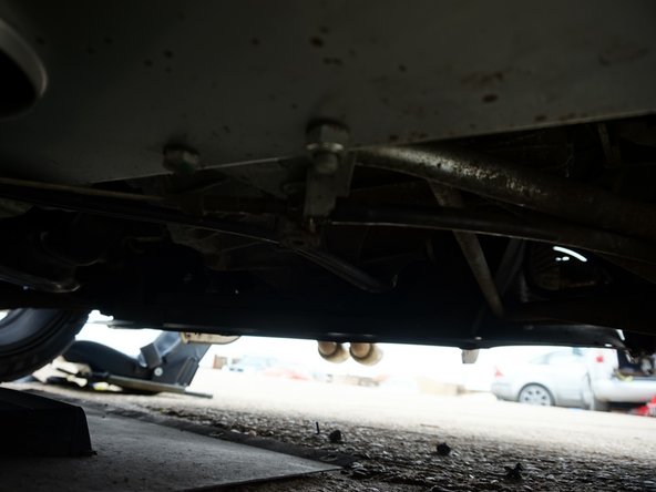

  6. Beta Installation of AliTech Shifter, Handbrake Cable Adjustment: passo 6, immagine 1 di 2 Beta Installation of AliTech Shifter, Handbrake Cable Adjustment: passo 6, immagine 2 di 2
    • Before you start with the installation of the AliTech Shifter, it is advised that you first slacken the handbrake cabel.
    • This needs to be done as the handbrake mechanism sits higher and further forward than the stock Lotus shifter.
    • To do this, you will first need to remove the rearmost floorpan to gain access to the handbrake adjuster.
    • Unfortunately our pictures here aren't very clear, but they show the floorpan undone and removed with a number of fixings around the circumference.

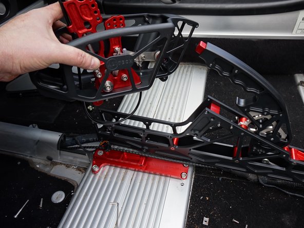

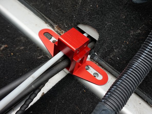

  8. Beta Installation of AliTech Shifter, Rear AliTech Mount: passo 8, immagine 1 di 2 Beta Installation of AliTech Shifter, Rear AliTech Mount: passo 8, immagine 2 di 2
    • Build the rear bracket upside down using the 4x M4 countersunk bolts supplied making sure that he gear selector and handbrake cable pass through the assembly as shown.
    • Rotate the assembly to its correct orientation and place into its final resting position so the slots align with the bolts holes your seat rails use (Different hole locations are used on LHD and RHD cars.)
    • Note: The rear bracket isn't bolted down until the seats are refitted.

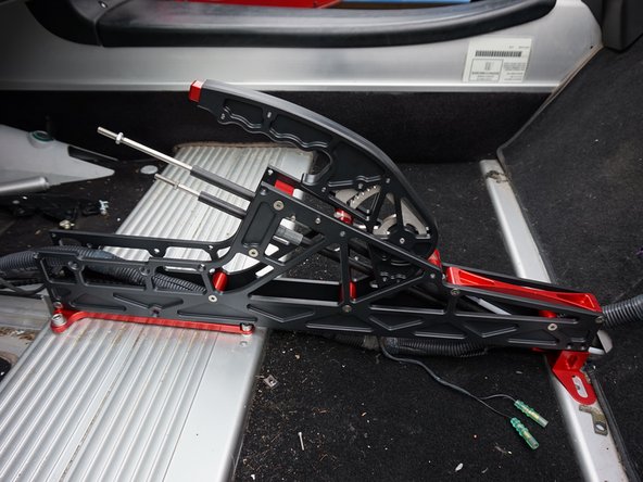

  9. Beta Installation of AliTech Shifter, AliTech Shifter Chassis: passo 9, immagine 1 di 3 Beta Installation of AliTech Shifter, AliTech Shifter Chassis: passo 9, immagine 2 di 3 Beta Installation of AliTech Shifter, AliTech Shifter Chassis: passo 9, immagine 3 di 3
    • Note: To aid installation, we recommend removing the the shifter assembley from the shifter chassis.
    • Trial fit the shifter chassis to the front and rear mounts. Whilest doing this, be sure to feed the shifter and handbrake cable through the shifter chassis assembley.
    • Once in situ, check that the front of the shifter sits flush over the front mounting bracket. If misaligned, as described in Step 7, insert washers beneath the mounting bracket so that the shifter chassis fits flush (no gaps)
    • Remove the cable block from the shifter chassis. Feed the shifter cables through the shifter block, securing them in place using the dowel pins supplied. Longer cable - top, shorter cable - bottom.
    • Note: The cable block is handed. The holes should be nearest to the right hand side of the shifter assembly - this is to give clearance for the handbrake assembly and cable.
    • With the cables attached, install the shifter chassis to the front mounting bracket. The wiring loom should also be fed inside the shifter chassis at this stage.

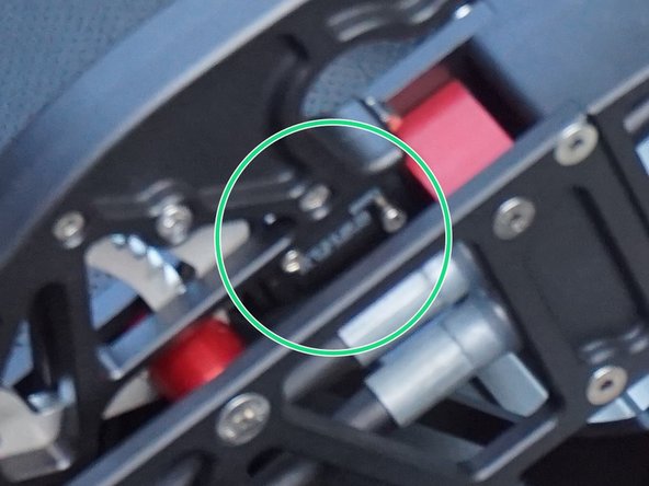

    • Fit the handbrake switch to the Shifter Chassis using the supplies M3 bolts.
    • Note: The switches vary, so may require a degree of adjustment to work.
  11. Beta Installation of AliTech Shifter, Shifter Mechanism: passo 11, immagine 1 di 3 Beta Installation of AliTech Shifter, Shifter Mechanism: passo 11, immagine 2 di 3 Beta Installation of AliTech Shifter, Shifter Mechanism: passo 11, immagine 3 di 3
    • Attach the supplied rod ends to the shifter cables. These will be tightened shortly.
    • Refit the shifter mechanism to the shifter chassis whilst being sure to use the longer M5 countersunk bolts on the left side, and the shorter ones on the right side.
    • With the shifter in its 'neutral' position, adjust the rod ends until they align with the desired holes on the lever arms.
    • Note: We suggest opting for the middle holes to start with.
    • Note: Lower holes = longer throw. Higher holes = shorter throw.

    • You're done! Go enjoy your new toy, and send us a photo of your installation for us to share on our Facebook page.
