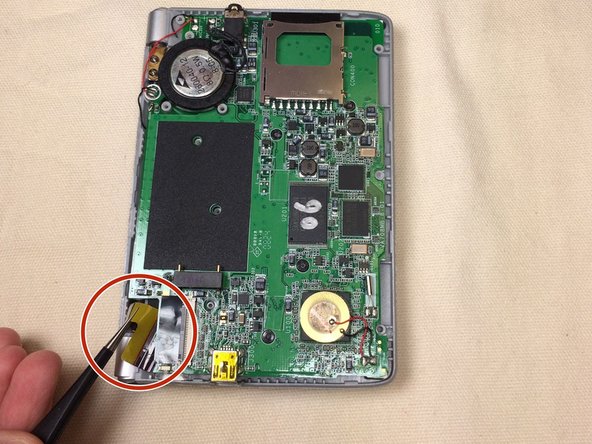

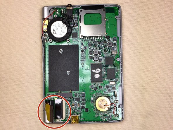

  9. Besta Super 5000 Keyboard Replacement: passo 9, immagine 1 di 3 Besta Super 5000 Keyboard Replacement: passo 9, immagine 2 di 3 Besta Super 5000 Keyboard Replacement: passo 9, immagine 3 di 3
    Attrezzo utilizzato in questo passaggio:
    • Using a pair of tweezers, pinch the center of the yellow ribbon located in the corner of the device.
    • Potential for device damage: Do not yank or remove the ribbon from the device.
    • Carefully pull the hidden piece of yellow ribbon out from underneath the motherboard.

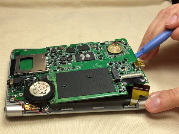

  10. Besta Super 5000 Keyboard Replacement: passo 10, immagine 1 di 2 Besta Super 5000 Keyboard Replacement: passo 10, immagine 2 di 2
    • Potential for device damage: All screws must be removed before you begin this step. Do not forcefully pry apart the motherboard with screws still in it because you may damage it.
    • Carefully pry off the motherboard with an opening tool.
  11. Besta Super 5000 Keyboard Replacement: passo 11, immagine 1 di 1
    • Take the motherboard out of the body frame.
