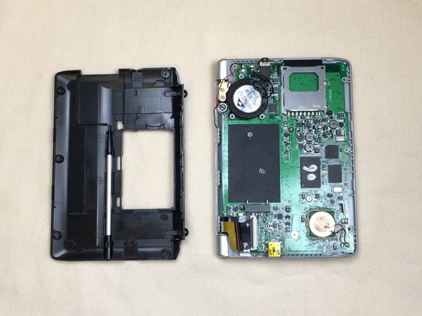

  6. Besta Super 5000 Back Cover Replacement: passo 6, immagine 1 di 2 Besta Super 5000 Back Cover Replacement: passo 6, immagine 2 di 2
    • Potential for device damage: All screws must be removed before you begin this step. Do not forcefully pry apart the device with screws still in it because you may damage it.
    • Gently pry off the backing using an opening tool.
