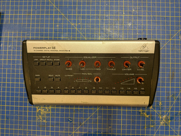

  2. Behringer Powerplay P16-M button and controls board removal, Free the board from the back plate: passo 2, immagine 1 di 3 Behringer Powerplay P16-M button and controls board removal, Free the board from the back plate: passo 2, immagine 2 di 3 Behringer Powerplay P16-M button and controls board removal, Free the board from the back plate: passo 2, immagine 3 di 3
    • Remove the two silver Phillips #2 screws from the back plate.
    • With the P16-M face down on the table, ease the circuit board away from the back plate to free the connectors from their slots, then manoeuvre it out of the case.

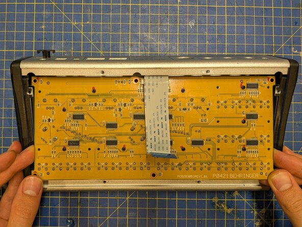

  3. Behringer Powerplay P16-M button and controls board removal, Disconnect the ribbon: passo 3, immagine 1 di 3 Behringer Powerplay P16-M button and controls board removal, Disconnect the ribbon: passo 3, immagine 2 di 3 Behringer Powerplay P16-M button and controls board removal, Disconnect the ribbon: passo 3, immagine 3 di 3
    • Push on the plastic tabs either side of the ribbon connector to free the ribbon.
    • Pull on the ribbon cable to remove it. This should barely require any force.

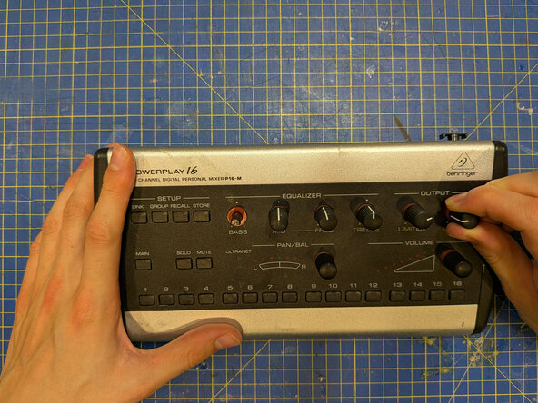

  4. Behringer Powerplay P16-M button and controls board removal, Remove the knobs: passo 4, immagine 1 di 2 Behringer Powerplay P16-M button and controls board removal, Remove the knobs: passo 4, immagine 2 di 2
    • With the P16-M flat on the table, remove all the knobs from its front panel. To do this, grip each knob and pull it straight up. This may require some force.
    • When reassembling and putting the knobs back on, it's probably worth supporting the circuit board with a finger behind each one to prevent it from bending (though avoid touching the components on the circuit board).

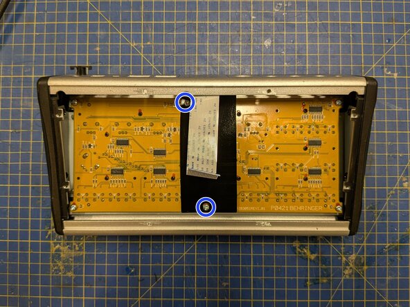

  5. Behringer Powerplay P16-M button and controls board removal, Remove the plastic piece: passo 5, immagine 1 di 3 Behringer Powerplay P16-M button and controls board removal, Remove the plastic piece: passo 5, immagine 2 di 3 Behringer Powerplay P16-M button and controls board removal, Remove the plastic piece: passo 5, immagine 3 di 3
    • Remove the two screws holding the plastic piece down.
    • Put the plastic piece aside.

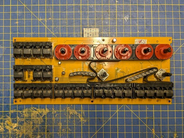

  6. Behringer Powerplay P16-M button and controls board removal, Remove the board: passo 6, immagine 1 di 3 Behringer Powerplay P16-M button and controls board removal, Remove the board: passo 6, immagine 2 di 3 Behringer Powerplay P16-M button and controls board removal, Remove the board: passo 6, immagine 3 di 3
    • Remove the remaining four screws from the corners of the board.
    • Manoeuvre the board out of the casing.
