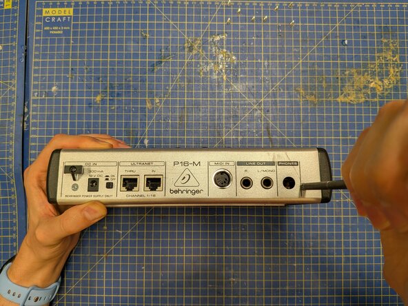

  1. Behringer Powerplay P16-M IO/Processing circuit board removal, Remove the bottom plate: passo 1, immagine 1 di 3 Behringer Powerplay P16-M IO/Processing circuit board removal, Remove the bottom plate: passo 1, immagine 2 di 3 Behringer Powerplay P16-M IO/Processing circuit board removal, Remove the bottom plate: passo 1, immagine 3 di 3
    • Remove 10 Phillips #2 screws from around the edges of the bottom plate
    • Some of these screws are longer than others, so it's worth keeping track of which one came from where.
    • Use a spudger or flathead screwdriver to lever the bottom plate free.

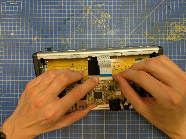

  2. Behringer Powerplay P16-M IO/Processing circuit board removal, Free the board from the back plate: passo 2, immagine 1 di 3 Behringer Powerplay P16-M IO/Processing circuit board removal, Free the board from the back plate: passo 2, immagine 2 di 3 Behringer Powerplay P16-M IO/Processing circuit board removal, Free the board from the back plate: passo 2, immagine 3 di 3
    • Remove the two silver Phillips #2 screws from the back plate.
    • With the P16-M face down on the table, ease the circuit board away from the back plate to free the connectors from their slots, then manoeuvre it out of the case.

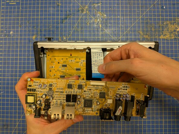

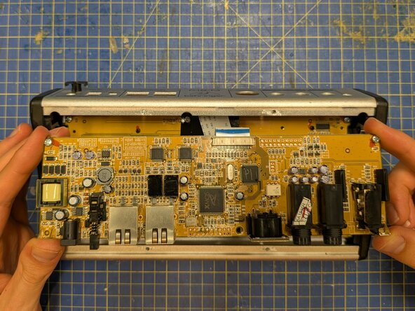

  3. Behringer Powerplay P16-M IO/Processing circuit board removal, Disconnect the ribbon: passo 3, immagine 1 di 3 Behringer Powerplay P16-M IO/Processing circuit board removal, Disconnect the ribbon: passo 3, immagine 2 di 3 Behringer Powerplay P16-M IO/Processing circuit board removal, Disconnect the ribbon: passo 3, immagine 3 di 3
    • Push on the plastic tabs either side of the ribbon connector to free the ribbon.
    • Pull on the ribbon cable to remove it. This should barely require any force.
