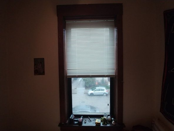

  1. Bali Custom Blinds Replacement, Blinds: passo 1, immagine 1 di 1
    • Measure the window frame width.
    • This measurement will be used to buy your new replacement blinds.
    • Mark where the top center of your window frame is for future reference when installing the center support bracket.
    • Blinds are not supposed to fit noticeably tight into the window frame.
    • Leave an inch of room (half inch on each side) so it can hang properly within the installation brackets.
