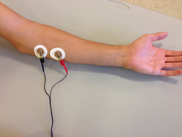

  6. Backyard Brain's Human-Human Interface Assembly: passo 6, immagine 1 di 3 Backyard Brain's Human-Human Interface Assembly: passo 6, immagine 2 di 3 Backyard Brain's Human-Human Interface Assembly: passo 6, immagine 3 di 3
    • Place two electrode pads on the muscle bellies of the forearm of the controlled volunteer as illustrated.
    • Attach the TENS Device to the controlled volunteer by clipping the red and black alligator clips to the electrode pads on the forearm of the controlled human. The sequence of colors does not matter.
