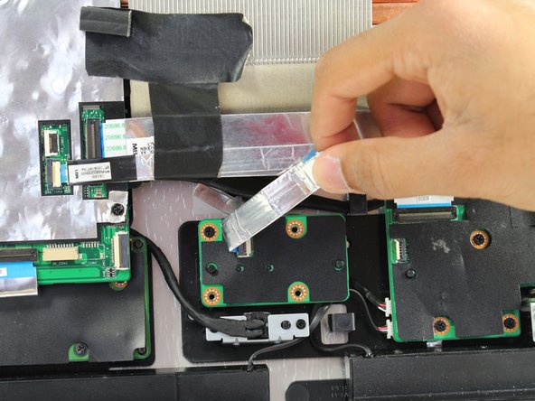

  7. Asus Zen AiO Pro Z240IC Ethernet/LAN Port Replacement, Ethernet/LAN Port: passo 7, immagine 1 di 2 Asus Zen AiO Pro Z240IC Ethernet/LAN Port Replacement, Ethernet/LAN Port: passo 7, immagine 2 di 2
    • Disconnect the ribbon cable from the side that has "MB" labeled on it by lifting up on the black locking flap and pulling the cable out of its terminal.
    • The black line on the ribbon cable marks the connecting region. When reinstalling, insert the cable up to this line so the locking flap covers it.
  8. Asus Zen AiO Pro Z240IC Ethernet/LAN Port Replacement: passo 8, immagine 1 di 3 Asus Zen AiO Pro Z240IC Ethernet/LAN Port Replacement: passo 8, immagine 2 di 3 Asus Zen AiO Pro Z240IC Ethernet/LAN Port Replacement: passo 8, immagine 3 di 3
    • Remove the four (4) 3.2 mm screws with a Phillips #1 screwdriver.
    • One screw is hidden under the ribbon cable.
    • Lift the board gently upwards to remove it from the base of the computer.
