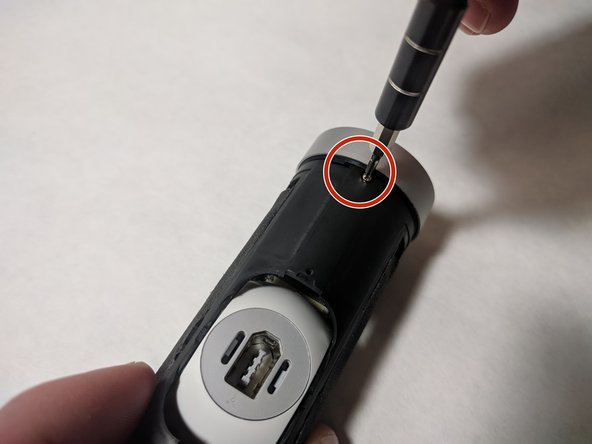

    • Unscrew the 3 (3.55 mm) screws surrounding the black casing near the camera-lens.

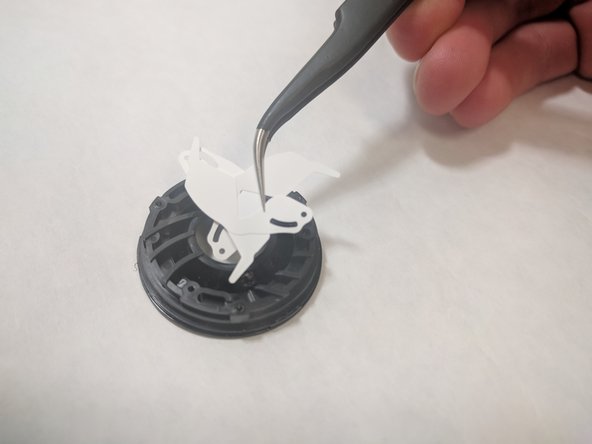

    • Pull off the top piece of the lens aperture.
    • Finally, remove the privacy lens using tweezers.
