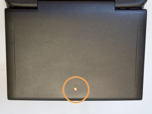

    • To begin this repair process first position the Powerbook towards you with the monitor closed, also make sure the laptop is away from anything that can cause a fire, self harm, etc.
    • Press the battery removal latch located on the right side of the front panel.
    • Gently slide the battery out. Make sure you place the battery in a safe place where it can also be easily accesible
    • ALSO NOTE: The keyboard, front pane, and hard drive are connected to the laptop's logic board via a ribbon cable. Lift up slowly on each component with one hand and disconnect the ribbons from their ports on the logic board.

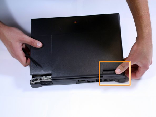

    • Begin by locating the side panel covers.
    • Remove the side panels by pulling up and towards the rear of the laptop.
    • Remove the two Torx #8 screws using a TR8 Torx security screwdriver.
    • You need to remove the screws from the left and right side panels.

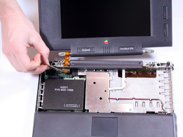

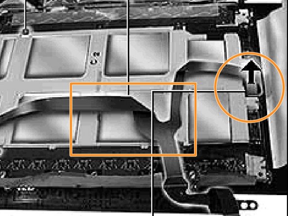

  6. Apple Powerbook 5300 Display Replacement: passo 6, immagine 1 di 2 Apple Powerbook 5300 Display Replacement: passo 6, immagine 2 di 2
    • Disconnect the ribbon cable from the logic board.
    • Potential for device damage: The cable is twisted around the monitor hinge, so do not pull up. Unravel the cable from the hinge first.

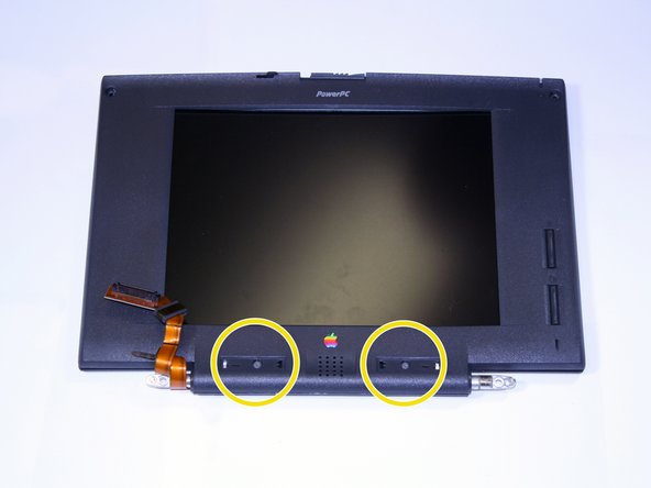

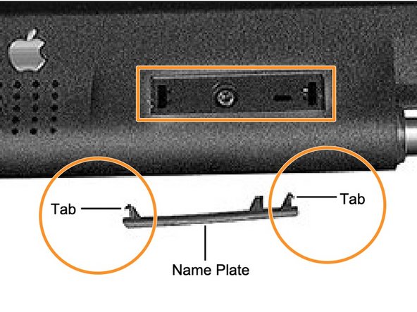

    • Use a pin to pry up the Powerbook 5300 and Macintosh logos to reveal two screws.
    • Using a spudger, remove the two product nameplates to expose the underlying screws.
    • Remove two Torx #8 screws.
    • Be care when using the spudger not to break the tabs on the nameplates.

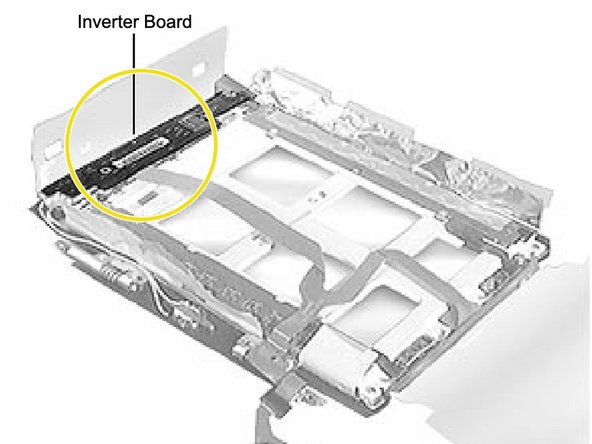

    • Use a prying tool to open the two halves of the display assembly.
    • Lift the top half away from the bottom half to expose the inverter board.
    • Look for the barcode on the left to be sure you have reached the inverter board.
    • As part of the PowerBook 190/5300 Repair Extension Program, the two rightmost screws on some displays were replaced with patch lock screws.

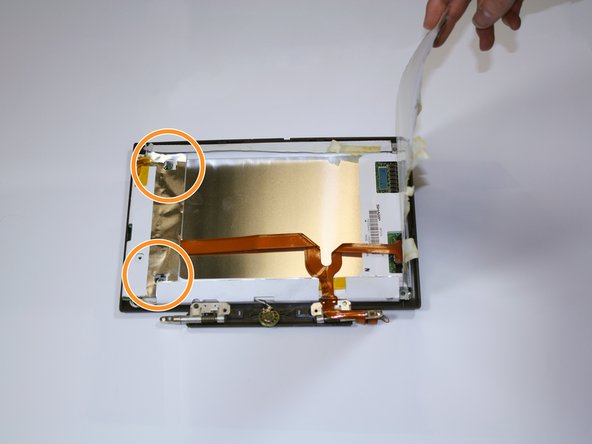

    • Remove the two remaining screws holding the display to the display bezel.
    • Disconnect the display cable from the display by gently pulling straight up on the reinforced backing of the cable.

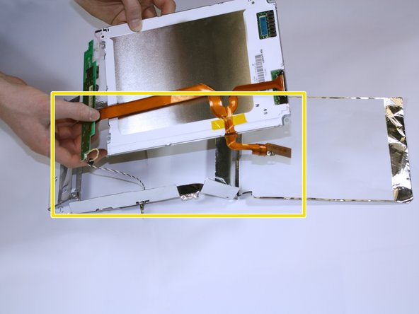

  13. Apple Powerbook 5300 Display Replacement: passo 13, immagine 1 di 3 Apple Powerbook 5300 Display Replacement: passo 13, immagine 2 di 3 Apple Powerbook 5300 Display Replacement: passo 13, immagine 3 di 3
    • Lift the entire paper and monitor assembly out of its casing. Remove the display from the bezel.
    • Remove the display EMI insulator.
    • Pull up the actual monitor out of its paper shell.
    • Potential for device damage: Be careful not to rip the paper. Watch out for any other wires that might get caught and the speaker cable which is connected to a speaker in the front of the monitor casing.
