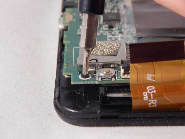

    • Remove the three screws that are located at the top of the circuit board with the screwdriver. (2.4 mm head, 3.9 mm in length)
